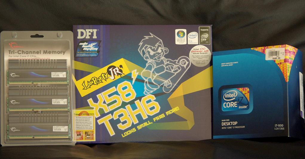

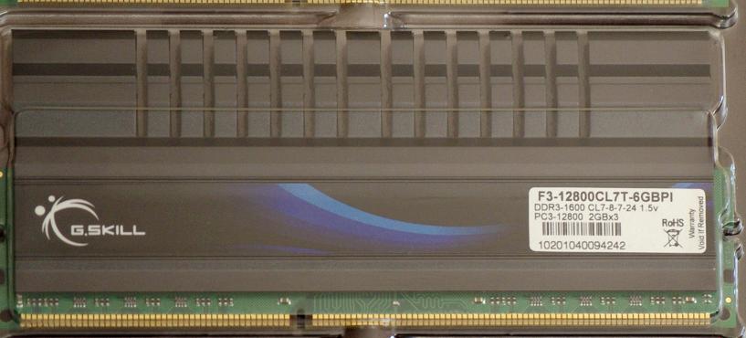

Overhaul hardware for my RIG is here.

Great looking rigs!
Still tweaking my DFI X58 JR build. Just got the H50 installed and everthing is running well.
Youtube movie of my build so far. It's a mess but it's under construction.
The swap is finished. DFI p45 JR to DFI X58 JR.
Proper cooling is set up. Time to tune the i7-930 for speed and stability with single HD5770 then I'll put another HD5770 in for Xfire.
Video of what it is looking like so far.
http://www.youtube.com/watch?v=cKxwPmfISNQ
