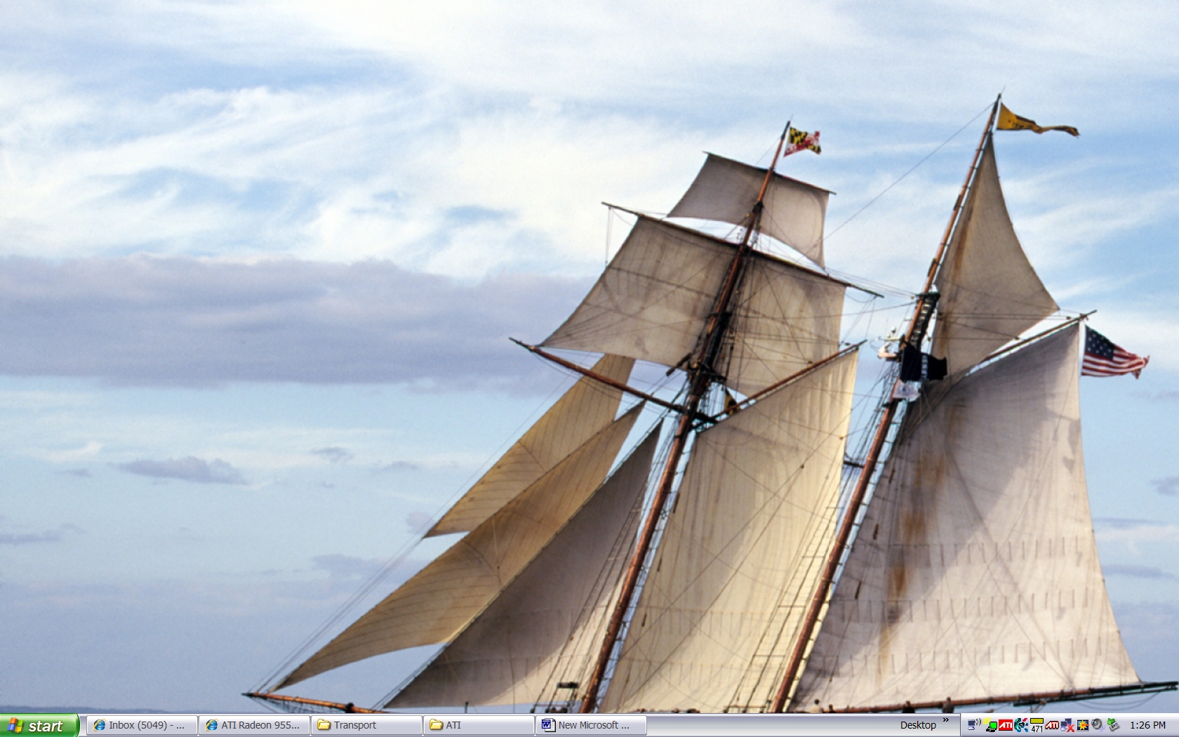

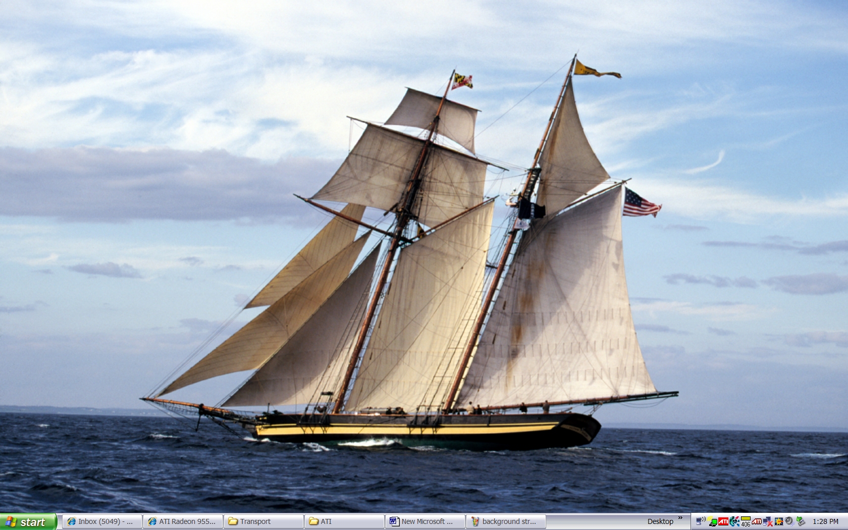

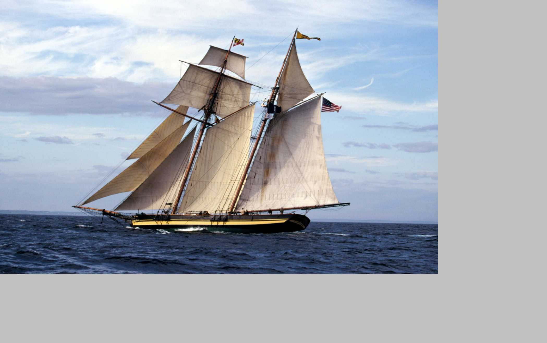

Here you go
What it looks like without adjusting the image size (this is the standard 1680 X 1050 image)
The enlarged image to correct it
and what it looks like after the large image in used as the desktop background.
