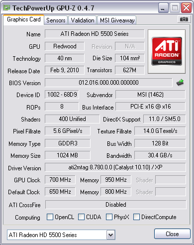

Quote:
Originally Posted by maggiore81 View Post
I have not found anything useful about that. Can you better drive me to the right direction?
For example here.
I tried with afterburner but the fan is NOT changeable
In that case it is most likely that you will not succeed with RBE either. It's still worth giving it a try, but chances aren't too good...

Quote:
Originally Posted by Radical_Edward View Post
Uhhh, I have the same card as you and I know for a fact it is.
Well then it isn't the same or you used a different Driver. Mine has 10.10 in it.

Thanked 314 Times in 269 Posts
System Specs
My subvendor is MSI
