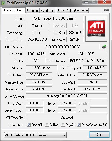

Well GPU clock goes to 880Mhz & memory clock to 1375Mhz instead of (800/1250).
Fact is that both 6950 and 6970 seems to be just the same but the memory chip used on both cards are different.
For me with everything unlocked, it was working yesterday but today after 5 mins of gaming i got my pc to freeze.. So i flashed back the shaders only bios using fullinfusion method and i had no freeze anymore. I'm using similar card in crossfire.
Normally i could increase the memory voltage in order to get the memory stable but at this point i had to used another mod bios and its quite late today so I eventually do that tomorrow.

If I change the voltage in latest version of MSI afterburner, does it actually change?
In GPU-Z it still says 1.1V even if I change it to 1.175V in Afterburner, has it actually changed?

GPU-Z always reads a max of 1.1 if you are on a 6950 bios, even in you increase voltage. (this was edited from what I said earlier) You can tell if the voltage increased for sure if you can run a higher OC then before.
For instance, on 1.175v, you should be able to run a gpu clock of 900-910 stable. That wouldn't be possible at the default 1.1v

GPU-Z always reads a max of 1.1, even if you flash the 6970 bios with 1.175. You can tell if the voltage increased for sure if you can run a higher OC then before.
Oh right, I have mine running at 900/1375/1.175 at the moment.
Quick question, in BFBC2 I seem to be getting horizontal screen breaking sometimes. Is this normal? It seems to happen even on stock 6950 clocks

GPU-Z always reads a max of 1.1, even if you flash the 6970 bios with 1.175. .....
thats not true if u flash 6950 with 6970 bios gpu-z shows 1.175v

Quote:
Oops, my bad. Flashing to 6970 bios does show 1.175v in GPU-Z, sorry. Already edited the other post...

Hi to everyone,
I have a Sapphire 6950 with shaders unlocked only. I want to raise the VID using RBE to change the voltaje from 1.1v to 1.175v to try and reach 900/1375, but I don't know which VID I have to change.
If anyone could help me with this, I would really appreciate it. I don't want to start doing trial and error with the bioses.

Quote:
Originally Posted by manofthem View Post
Yes I'm on stock cooler. The 56*C/58%fan was while the new CoD game, but while running Crysis temps and fans go up some more. But my case has has lots of fans, which helps keep it cool. Your gpu seems like it's high in idle though. Are you running 2 in CF?
Yep running 2 6950s with unlocked shaders in CF
Does this affect it?:P
Also for cooling i have.
5x120mm intake fans (4 at front with 4xCM Stacker bays, 1 on side panel)
2x120mm out fans(back) (one has H70 Radiator attached with a 2nd fan not counted in the list)
1x200mm out fan (top)
Stranger is offline
If you have a good card you can run 900MHz on lower voltages. My card does 900/1465 at 1.11v (too bad not 1.1v ) and it's very efficient this way. Beyond 900 it needs about 20-25mV more per 10MHz, so it gets hotter, louder and requires more power. I only have a 500Watt power supply so I'm keeping it at these speeds for the moment.
VinnieM is offline

Quote:
My XFX 6950 is running 900/1375@1.175v. Anything higher and it crashes on me. Not right away though, and it passes benches. But say an 1/1.5 hours of straight gaming, and it'll freeze on me(driver stops responding and need to reboot). Maybe I'll try reinstalling drivers...
But it's good to see someone can hit high clocks on low voltage. This will be my last xfx I buy most likely.
