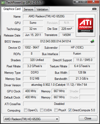

OpenCL is not getting detected for my HD6230 either (AMD Fusion E-450).
DirectCompute 5.0 is detected but not OpenCL even though i've installed the runtime thingie with the drivers. Catalyst 11.12.

Quote:
please post a gpuz and gpu caps viewer screenshot

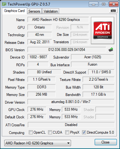

Hallo W1zzard
Same problem here with 2 GPUs.
The First 1 is ,
where the Opencl Device name is "BeaverCreek", according to clinfo.exe.
And the second one is ,
where the Opencl Device name is "Loveland", according to clinfo.exe.
thanx
