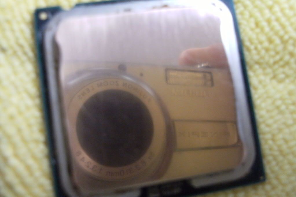

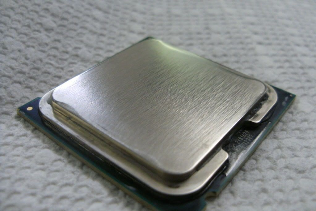

Oh yes I think you guys know what this little processor has in store for it
220 grit done, copper is all exposed. Here is what it looked like to start I had already done some work on it a long time ago (basically just brasso to make it shinier.
starting out
copper beginning to peak out
copper clearly exposed
just a little more to go
finished with 220
done with the 220 grit the copper is fully exposed, now I just need to make it shiny
on to 400 grit, I was going back and forth about whether or not to use 320 or just go up to 400. I decided on 400 and am glad. Only took about 5 minutes to finish it up.
this is from about 30 seconds of sanding already very little cross hatching left.
and done
here you can see a slight bit of reflection starting
so that wraps it up for 400 grit now on to 600
600 went by really fast too, I was really surprised by it!
still some crossing going on
and another almost done
all done, hard to tell the difference between 400 and 600 from pics but there I can see a big difference
not a big improvement with the reflections
and on to 1500 grit hopefully it doesn't take too long...
wasn't too bad. There was a nasty scratch in the middle of the chip that took a while to get out but the whole thing still only took about 5 mintues. here you can see the scratch that I was talking about.
all done reflections are becoming quite clear
here you can see the reflections as well
brasso time!
Ok so the brasso is taking a long time but it is steadily getting better
jackie chan!
worked with the brasso for a while and it is slow going so I brought out the big guns :P
so I've been working with this off and on for a couple hours now (probably only a half hour of solid polishing) it is really slow going but I'm making progress so here is what it's looking like now mostly taking pics of things reflecting in it
Durp I found out why that was taking so long I forgot to use rubbing compound! I may yet finish this tonight!
Well here are the results of using the rubbing compound
there it lies
getting started
and wrapping up not too bad
I'm going to spend more time on my core 2 quad because I actually use it. This was something of a test you could say?
I like how it turned out but I think I could do better, and I plan to on the q6600!

Old May 19, 2012, 05:48 PM   #2
francis511
2000 Posts
francis511's Avatar
Join Date: Oct 2006
Location: N.Ireland
Posts: 2,363 (0.98/day)
Thanks: 145
Thanked 277 Times in 257 Posts
System Specs
Going to take picz ?

what processor is it?

shows Core2 E8200 next to the proc in the image

yup workin with 220 grit now to get down to the copper.
Quote:
yeah.... lol

yeah I'm going to, I'm uploading some right now from the 220 grit. Got the copper all exposed time for 400grit then 600 then 1500 finally brasso.

you are going to be spending a ton of time with 1500 grit coming right from 600, just saying you may want a step or two in the middle there

yeah I know but they didnt have 1200 or 1000 at ace so i'll work with what I have

All good man, just trying to help out, wasn't sure if you had even looked

brasso is taking forever...
I'm taking a break on this, finishing it this evening.

i tried actual lapping paper on this PhenomII 960T, and i heartily recomend it, i still used harsher 1000 to start but the lapping paper(2grades) was amazeing stuff another good thing to use is car bodywork cutting compound as a finisher its great.

rubbing compound! why did I forget it? I knew the last time I did this it took less time and looked better

I always go to a automotive store, they usually have a larger variety of sand papers, people doing body work need a lot of different grits.

Put the processor back in (decided against wasting thermal paste) it runs toasty now, probably because of the lack of paste? Under full load it got up to 80! This is just cause I'm not using paste right??

Yes, you need thermal paste.
erocker is offline
Reply With Quote
Old May 20, 2012, 06:54 PM   #18
anonymous6366
200 Posts
anonymous6366's Avatar
Join Date: Jun 2009
Location: Chillicothe IL
Posts: 217 (0.15/day)
Thanks: 21
Thanked 27 Times in 21 Posts
Send a message via AIM to anonymous6366
System Specs
Quote:
yeah I wiped a little off of the other processor and even with that tiny amount the temps are down to ~55
__________________
-ΣΦΔ-
anonymous6366 is offline
Reply With Quote
Old May 20, 2012, 09:38 PM   #19
Goodman
1000 Posts
Goodman's Avatar
Join Date: Jun 2009
Location: Canada/Québec/Montreal
Posts: 1,506 (1.05/day)
Thanks: 253
Thanked 328 Times in 247 Posts
System Specs
Don't want to dismiss your work (time consuming) but all that for a 1-3c better temp at best
Back then (8-10 years ago) it was ok to do this as we didn't have much of good cooling out there & no heat pipes or so rare that it was really expensive to buy one
Now a days we got much better , cheaper & efficient cooler & some much better Tim that doing this type of works is pretty much worthless & unsafe (brasso) to do
Anyhow it's your time to "waste" not mine & all i can said is good luck!
Goodman is offline
Reply With Quote
Old May 20, 2012, 11:05 PM   #20
anonymous6366
200 Posts
Join Date: Jun 2009
Thanks: 21
System Specs
Quote:
idk, when I did this with my friends a couple years ago I seem to recall getting ~5c cooler temps.
__________________
-ΣΦΔ-
Reply With Quote
Old May 20, 2012, 11:31 PM   #21
v12dock
1000 Posts
v12dock's Avatar
Join Date: Dec 2008
Location: Central Illinois
Posts: 1,286 (0.80/day)
Thanks: 281
Thanked 240 Times in 160 Posts
System Specs
Trick is not to use a finishing compound
v12dock is offline
Reply With Quote
Old May 20, 2012, 11:53 PM   #22
anonymous6366
200 Posts
Join Date: Jun 2009
Thanks: 21
System Specs
Quote:
was that what we did?
__________________
-ΣΦΔ-
Reply With Quote
Old May 21, 2012, 12:02 AM   #23
v12dock
1000 Posts
v12dock's Avatar
Join Date: Dec 2008
Thanks: 281
System Specs
It leaves an wax film best results would be rubbing compound and ultra high grit sandpaper.
v12dock is offline
Reply With Quote
