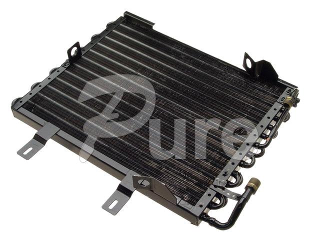

Originally Posted by de.das.dude View Post
this is just a cooler with use only in places were space is limited. think servers and HTPCs
Dude, this thing can replace the condenser in a Air Conditioning unit.
That's a condenser! ( albeit a fairly big one)
pantherx12 is offline
Reply With Quote
The Following 2 Users Say Thank You to pantherx12 For This Useful Post:
Old Jul 4, 2012, 11:16 AM   #121
qubit
Overclocked quantum bit
qubit's Avatar
Join Date: Dec 2007
Location: Quantumville UK
Posts: 8,640 (4.34/day)
Thanks: 4,169
Thanked 3,301 Times in 1,941 Posts
System Specs
Quote:
http://upload.ecvv.com/upload/Produc...9171356326.jpg
That's a car radiator! You rascal!

Quote:
Not according to it's URL!
URLS don't lie man
yeah, thats good
I understand, what I hope to be, the sarcasm. The issues are:
1) Water cooling in a car is done by simple heat transfer. There is no condenser, as no phase change occurs.
2) The energy required to spin this thing will prohibit it from being used in larger applications. Maintaining that kind of velocity with a higher moment of inertia would require substantial motor power, which would make the cooling system less efficient.
3) Radiators provide a surface so that heat can be ejected into the surrounding environment, rather than circulate within the fluid loop. Condensers shift the phase of a material (usually gas to liquid in cooling), so that the cooling loop can use the subsequent phase change back to remove energy from the system.
__________________
You haven't seen anything until you've seen this.
*pokes computer*
Wow! I didn't know the blue screen of death could get a blue screen of death.

Quote:
Waaaaahhhh?
1. Why are you talking about radiators on a post about condensers.
2.This thing doesn't require all that much power, after all once it get's going it supports it's own weight so will be spinning like a regular fan surely. ( and thus use the same amount of energy as a fan spinning at the same speed, did you see how long this thing can coast for? so long as once upscaled they still support their own weight they would likely use the same amount of energy. Considering some air conditioning fans use silly amounts of amps already this shouldn't really be a problem,)
3. Yes I know this, I'm so confused man lol.
I'm not sure what any of that has to do with what I said.
Sandia have a condenser type design within their PDF ( it's basically two Sandia coolers and copper piping)
