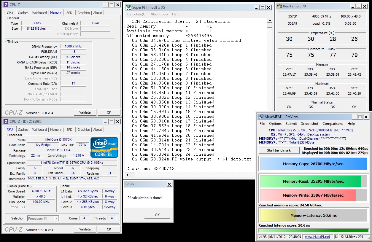

Old Nov 17, 2012, 04:56 AM   #15
SonDa5
1000 Posts
SonDa5's Avatar
Join Date: Aug 2008
Posts: 1,437 (0.81/day)
Thanks: 220
Thanked 288 Times in 186 Posts
System Specs
Quote:
Originally Posted by wrathchild_67 View Post
I'd be interested to see what they could do at 2133Mhz since I'm stuck on Sandy Bridge and that is the highest speed the memory divider allows without upping bclk. Here's what I've got on my Samsung Green's ($30 for 8GB, amazing!):
Those are a great value but they didn't work out well on my MSI motherboards. I tried them on a Z68 and Z77 MSI mother board and best I could get was 2133mhz CL9 and it was only stable at speeds below 5GHZ on CPU.
I just did a quick ram adjustment of 2133mhz CL 9-11-10-27 1T 1.5v and my new Gskill sticks are buttery smooth with these settings.
http://valid.canardpc.com/2585133
Ambient Temps 23.5C

Found a sweet spot for 24/7 5ghz.
Ambient Temps 24C
RAM 2133mhz CL 9-11-10-27 1T @1.5v
3570k@5ghz with 1.376v
http://valid.canardpc.com/2585171
This ram rocks!

Quote:
Ambient Temps 24C
http://minidriven.com/BlacknBlueforI...47lowv5ghz.jpg
This ram rocks!
I get 9/10/10/20/1T at 2133MHz with 4 x 4G.
