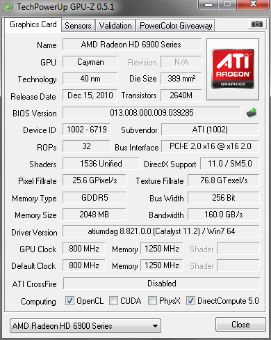

System Specs
Ok what I did was install WinFlash Dl the HIS BIOS RAN WinFlash as ADMIN then programed card...rebooted it was that simple...make sure you run WINFLASH as ADMIN and that you place the HIS BIOS in the WinFlash Folder to make it easier to find.
http://www.techpowerup.com/gpuz/kn8m6/
