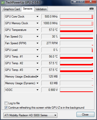

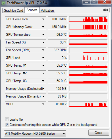

==Update==
I seem to have found the issue thanks to GPU-Z, but I'm unsure of how to actually solve it.
This picture is of GPU #2, while idle. Just booted up, opened nothing but GPU-Z itself.
Same as above, but GPU #1.
Is it supposed to be going up and down all the time while not even doing anything other than having GPU-Z and Firefox open as I type this?
Edit to add: I have found that it is actually a bug from the AMD 12.3 and 12.4 drivers. Will be deleting them and reverting back to an older version. Thanks for the help. Though it wasnt of help for this issue I'll keep the info about the heatsinks in mind.
