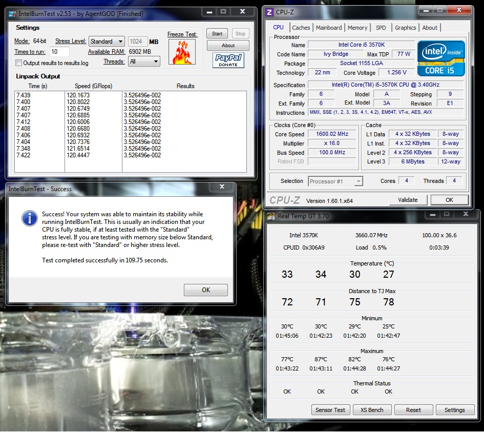

First time BOOT with 3570k with 4.5GHZ over clock
Got my 3570k on first day of release but didn't have time to install. This morning I had a some time so I finally got to swap out the SB i5-2500k for the 3570k from my MSI Z68A-GD65 G3 MB.
The swap went smooth. I installed the latest IB supporting BIOS for my MB last week so it was ready to just put it in and go.
Before booting up I wasted no time and went for an over clock.
1.22v on 3570k@4.5GHZ and I lowered my ram voltage to 1.5v since the IB has a stronger memory process I thought I could get away with lowering my ram voltage from 1.63v@2133mhz, CL 9-11-10-27 CR 1.
Once booted windows 7 immediately did a device update and I had to reboot. After that it booted up fine and I went straight to Intel Burn Test for stability testing.
http://valid.canardpc.com/show_oc.php?id=2352909
I'm impressed with the low voltage for the speed and the stability.
I'm also impressed with how I was able to lower the voltage on my ram.
This chip is beast. Idles very cool and when under load it does get hotter than my 2500k but it is rated for higher temps. I think this CPU is a real beast. Very happy with my first boot and over clock.
Running Swiftech HD water block for cooling with HWLABs 360 and 120 steath radiators.
That is where I am at so far. Time for IB fun.

Lower your PLL to 1.6 or 1.65 for lower temps as you go higher.

pll was at 1.8v.
thanks.

Was able to pass IBT stability test with same voltage at 4.6GHZ. PLL 1.75v

I hear the IQ on IB's are 15-20% higher than SB. Does that mean a 5ghz IB = a 6ghz SB? If so, your 4.5 is blazin in the speed department.

No, 4-10%.
about a 200-300mhz difference.

can you pass stability on IBT at anything above standard?

Quote:
+1 I would set MAX memory and MAX threads to test FULL stability

I really don't like running IBT for very long. I do the short test and it has worked out fine. I also run Memtest86 v4.2 for memory stability testing. These two benchmarks are fast and I don't see the need to run Prime95 for 24 hours. I don't want to burn up my CPU. I just do a quick test and its good to go. I use this method for extreme testing to find max limits for bench marking. Once I find max I back off some for 24/7 regular usage.
I have alot of tweaking to do with this new CPU. So far I am very happy with the low voltage and performance.

So dang, 1.22v for 4.5 (nice!), but you're temps are 72c+ on the water setup in your system specs? Hot hot hotty hottiee hot!

Actually 1.2v under load up to 4.7GHZ fine.
http://valid.canardpc.com/show_oc.php?id=2353505
Looking around online seeing what others are doing with air cooling it appears
actual surface area of die of 22nm IB may be so small that is matters very little if water cooling or air cooling is used at ambient temperature.
The magic of IB for extreme over clocking is happening with sub ambient coolant surfaces on the die.
I'm hoping to hit a stable 5GHZ on my 3570k with my water cooling loop.
One thing that I have noticed is over all temps on my water loop are cooler with IB than with SB and this helps my video card run a little cooler as well.
The IB chip does get hot but it doesn't heat up my loop as much as SB even though it ran cooler. (Good thing for water cooling when loop cools more than 1 block).

I'd test with 4GB of memory in IBT. I've had the higher memory setting catch some instabilities that the 1GB test didn't encounter.
Also, about IB getting hot, that's more of an IHS or TIM underneath it problem and not an actual TDP problem, correct? What does CPUID HWMonitor give you for wattage at idle/under load?
The chip runs hot because the 22nm die size has less surface area to displace heat and because of the design of the Tri-gate transistors. Changing the TIM to Fluxless Solder may not really make much of a difference to help dissipate heat because of the small 22nm surface area of the IB die.

Old May 3, 2012, 03:56 AM   #21
HTC
1000 Posts
HTC's Avatar
Join Date: Apr 2008
Location: Portugal
Posts: 1,925 (1.01/day)
Thanks: 461
Thanked 282 Times in 230 Posts
System Specs
Quote:
I'd test with the maximum allowed: for 8GB RAM total, that would be like 6+ GB or something.
__________________
HTC - Hoje Tive Cį
I'm PORTUGUESE: apologies for any spelling mistakes!
HTC is offline
Reply With Quote
Old May 3, 2012, 04:00 AM   #22
SonDa5
1000 Posts
SonDa5's Avatar
Join Date: Aug 2008
Posts: 1,437 (0.81/day)
Thanks: 220
Thanked 288 Times in 186 Posts
System Specs
Quote:
Not really needed IMO. STandard in windows environments is actually getting an insane stress level and still able to run OS stable. Over kill stress test IMO. I just use it to get stable for gaming and bench marking. Also helps me see how over clocking memory helps improve performance.
IBT with Memtest works well for learning about system performance.
SonDa5 is offline
Reply With Quote
Old May 3, 2012, 04:14 AM   #23
HTC
1000 Posts
HTC's Avatar
Join Date: Apr 2008
Location: Portugal
Thanks: 461
System Specs
Quote:
The purpose is to test as much of the RAM as possible while stressing the CPU: usually, the stress program only stresses part of the RAM.
__________________
HTC - Hoje Tive Cį
HTC is offline
Reply With Quote
Old May 3, 2012, 08:38 PM   #24
SonDa5
1000 Posts
SonDa5's Avatar
Join Date: Aug 2008
Thanks: 220
System Specs
After further tweaking I'm blown away by IB 3570k.
4.5GHZ 1.17V
http://valid.canardpc.com/show_oc.php?id=2355447
SB can't touch this.
SonDa5 is offline
Reply With Quote
