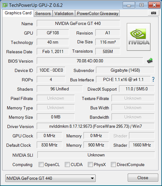

The card doesn't start its driver
i will post a image of my gpu card what is wrong?

it looks like your nvidia driver isn't loading properly.
gpuz reads the default clocks from the bios, which is ok.
the card itself is detected properly in gpuz, too, because gpu name, revision and transistors are correct.
have you tried reinstlaling the nvidia driver?

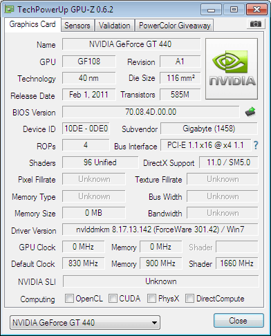

i installed all the drivers. only the motherboard not.because i do not find drivers.my cd that come with motherboard only have the xp drivers.
i reinstalled nvidia drivers but the device dont start and have error 43.

Quote:
Hi
Code 43
Windows has stopped this device because it has reported problems. (Code 43)
Recommended resolution
One of the drivers controlling the device notified the operating system that the device failed in some manner.
If you have already run the Troubleshooting Wizard, you might want to check the hardware documentation for more information about diagnosing the problem.
Source - http://support.microsoft.com/kb/310123
nb: I will ask once more, are you trying to run two VGA cards? one in AGP and one in PCIe as in your system specs
atb

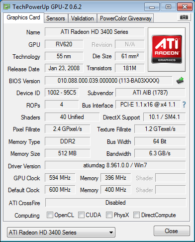

likely ill done all of this.i came back to my ati hd 3450.this card work like charm no conflicts.
i think the gt 440 its defected.i think the seller give me a broken card.
that card work the gt 440 dont.I WILL NEVER BUY A NVIDIA GRAPHIC CARD.THEY SUCK WITH THE DRIVERS AND DO NOT OFFER ANY SOLUTIONS OR HOTFIXES.
For law2.other my hd 3450 is compliant pci express 2.0 and working beautiful.
Why one card work and the other dont?thats im questioning
