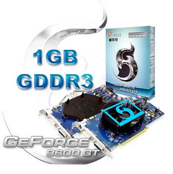

yeah i turned my v-sync off =) and lol its a good cooler i guess my 9600GT haha a sparkle 9600GT this one i got:
The stock clocks are: core clock 650mhz/memory clock 900mhz/shader 1625mhz and i clocked it by 100 and 100 and 65
Mine a 512mb not 1GB
