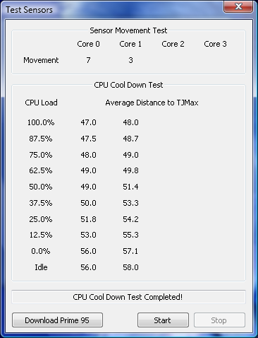

    CPU Cool Down Test
    I"ve just run the test on my Q9450, are the results anything to be concerned about?

    Looks OK to me. 60C in load at 3.2GHz is perfect fine. What cooler do you have and what's your room temperature?
    And don't worry about difference between cores this is "by design". :D

    burebista is right. Nothing wrong with 60C. As long as your computer runs stable at full load and none of your cores are thermal throttling then don't worry about the core temperature.
    The sensors for core0 and core2 track each other very well and are likely your most accurate sensors. None of them appear to be getting stuck in this temperature range which is far better than many 45nm Quads.
    It's very likely that core1 and core3 have a higher TJMax than core0/core2. Intel actually calls this spec TJ Target. Actual TJMax is typically equal to that spec or somewhat higher but Intel hasn't released any specific details about how much higher TJMax can range from one core to the next. Their opinion is that these sensors shouldn't be used to report absolute temperatures since they're not very accurate or calibrated for that purpose. They were only designed to control thermal throttling and thermal shut down and your sensors look OK for that purpose.
