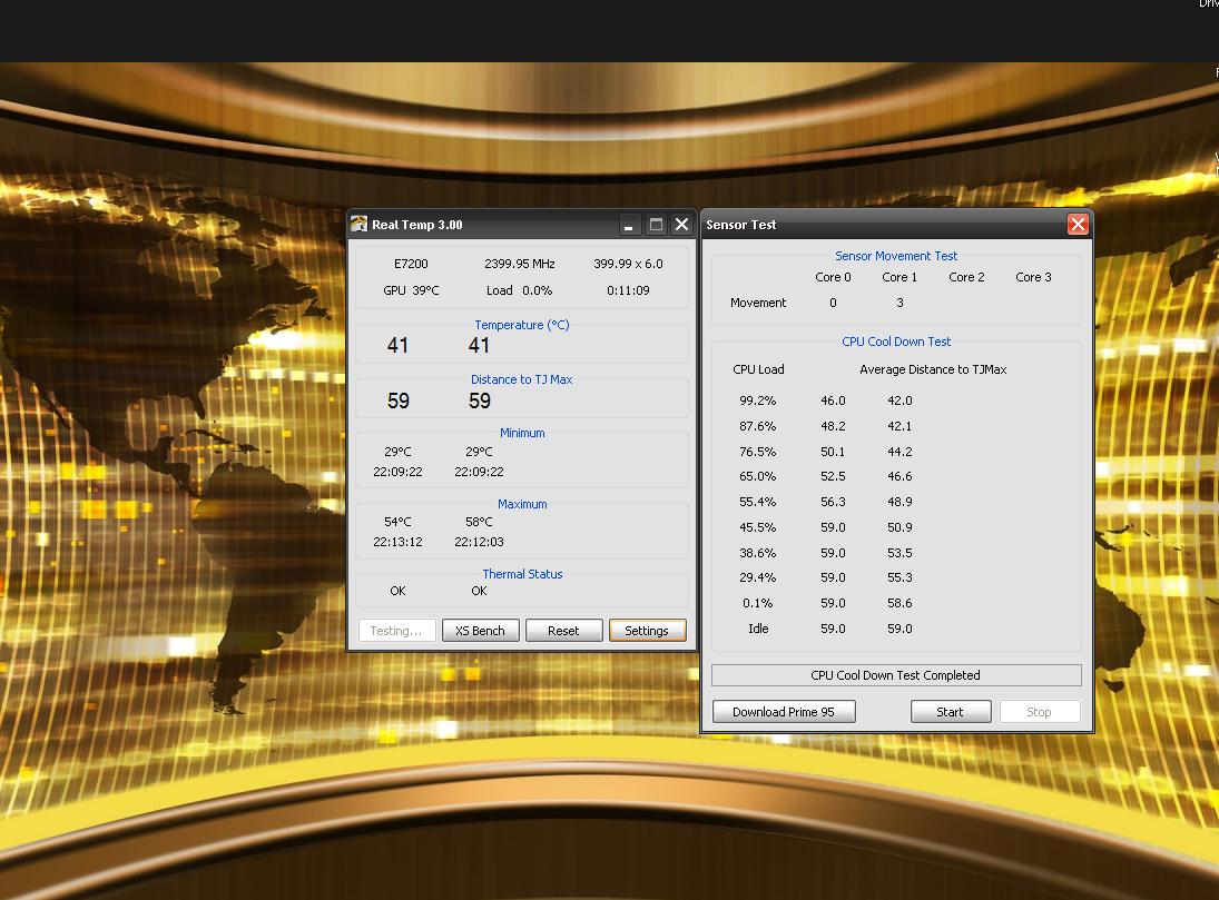

Here is the sensor test as requested Unclewebb. Sorry for taking so long to respond. I'm not registered at imageshack so I'll just post the here?
The sensor on core 1 seems to be responding to each change in temp, so I'm hoping thats the one I'm going to use. On the screenshot the minimum shows as 29, but I set the calibration back to 0 and didn't reset the temps afterward. The minimum should be 41 with no calibration, as shown again in the idle state. Hope this is what you wanted,and thanks for all the help thus far.:toast:

unclewebb
Jun 1, 2008
7,271 (1.26/day)
You don't need to be a member at Imageshack. You just upload images and they give you a link to them. I'm not sure how long they will keep images on their site if you're not a member but it seems to be for 6 months or a year or even longer.
See why I like the CPU Cool Down Test. It makes it very easy to spot a stuck sensor and your core 0 sensor is definitely stuck.
Looking at your numbers, I think somewhere around 70C or 75C, core 0 will catch up to core 1 and they will likely remain fairly equal from that point to TJMax. That's usually what happens.
No matter what you do, the idle temperature of core 0 is going to be a meaningless number. It's stuck at idle and there's nothing you can do about that except ignore it.
rge's testing was with an open case. If you also tested with an open case and your room temperature near your case is 17C then 29C or 30C sounds like a reasonable temperature number for your CPU. Most users don't use the OEM cooler for very long so I haven't done much testing but rge's numbers / guidelines seem OK to me.
It's typical for these sensors to read either too low or too high at idle but most of them are a lot more accurate at higher temperatures. A 10C degree error at idle is not unusual. Using a calibration factor somewhere around -8.0 for core 1 seems about right. Leave TJMax set to 100C for both cores. If your case was closed when you tested then you might need a little less calibration factor than that. The closer you duplicate rge's testing environment, the better your results will be.
After that I'd run Prime95 Small FFTs at your normal or overclocked speed and adjust the calibration factor on Core 0 to get the cores to line up reasonably well. It will probably need a positive calibration factor. Either that or just leave core 0 as is knowing that it's not a sensor you want to trust too much.

Thanks for having a look UncleWebb
That is exactly what I was doing, and my calibration was set to -8.0
And yes, I'll just forget about core 0 and work with core 1.
Thanks again:toast:

It seems i have my E8400 core 0 sensor ill calibrated
This is my previous CPU: a lapped E6850, using a Noctua NH-C12P heatsink.
And this is my E8400: non-lapped, and using the same heatsink as above. The RAM has changed and increased too.
As you can see, core 1 sensor is stuck but what i'm intrigued about is the higher temp of core 0, when compared to the E6850: this has been so since day one and with the same version of Real Temp too (i just don't have a pic of it with version 2.84 of Real Temp).
@ first i thought it was because of one CPU being lapped and the other not but, though the ambient temp has increased, the minimum temp of the E8400, @ idle, has not, even though it doesn't seem to be stuck: the lowest i have seen it was @ 30º but it fluctuates between 30 and 32, on idle (C1E enabled).
Here's a pic of Real Temp taken a couple of minutes ago, with my settings:
Maybe you can help sort this out.

File_1993: I apologize. I screwed up. I reversed the 7 degree difference. What I meant to say was
Core0 TJMax = 107
Core1 TJMax = 100
Can you try doing a Cool Down Test at 1600 MHz? I just want to make sure that both your sensors are still moving at this point. Rge's testing was with his case open so try to do the same when comparing to his numbers. A closed case can add a few degrees to your results so it's best to open it up to be consistent
With the 107/100 TJMax numbers, these two cores are going to track each other very closely from idle to TJMax. Then you might need similar negative idle calibration factors if your sensors are not sticking during your low MHz test. Let your CPU sit idle at 1600 MHz for a couple of minutes before recording the temperature.
HTC: None of the sensors on any Core processor are 100% accurate from idle to TJMax. None of them. Not the original 65nm CPUs like your E6850 and definitely not any of the 45nm Core 2 based chips. With a 15C/17C Minimum temperature being reported, it looks like the E6850 sensors read too low and likely your E8400 reads too high. These sensors are not designed for accuracy at very low temperatures and a 10C error isn't unusual. If one CPU has 10 degrees of error one way and the other CPU has error going the other way then the combined error when comparing two different CPUs can be significant.
The best way to figure out what's going on is to test both CPUs under identical conditions, same room temperature, core voltage and MHz and then compare your reported temperatures to what rge found during his testing:
http://www.xtremesystems.org/forums/showpost.php?p=3384504&postcount=2429
I wish the sensors were more accurate than this but they're not.
I thought it was possible for those temps on the E6850 since my house doesn't have AC and it was quite cold then, with ambient temp @ about 10º (i have this case).
What surprised me was that, when i placed the E8400, the temps were 15-20º higher, using the same CPU voltage and, @ the time, the same RAM.
The lowest temp ever on the E6850 (that i saw) was 15º on both cores with core 0 reaching that temp and staying there but with core 1, usually, with 4-6º more and spikes down to 15º.
Both CPUs have identical readings while running Linpack (i mean 1 core VS the other: not 1 CPU VS the other).
I'll try to use the same settings as the E6850 CPU for this but i won't be able to do it until this weekend. Hopefully, this might help to calibrate both CPU sensor readings.

Ok Webb, I will try that tomorow, including the cooldown at 1600Mhz. I did the calibration in my previous post at 1600Mhz, 1.1V and an opened case.

Did all of the wanted, here's how it looks now:
cooldwon test at 1600Mhz, 1.1V, open case, 19C
Calibrated, 1,1V, open case, 19C

Webb, instead of putting Core 1 with 107TJmax, would it be better if i put Core 0 on 100deg, and Core 1 on 93?
Something like this:
15C room temp, opened case, 1600mhz, 1.1V
