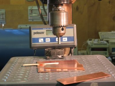

    Addressing the complaint of compression damage to sinks and CPU/IHS alleged to be caused by IC Diamond particle contamination
    Introduction
    After a full investigation by Innovation Cooling it was determined to be impossible to recreate the asserted damage as presented by any particle by compression whatsoever under a worst case model.
    Detailed examination of the damage was performed and a profile of the particle was developed that allowed an approximate matching model pieces to be manufactured
    The investigation encompassed impressing assorted forms of copper and found that cold rolled, forging or stamping processes hardened the IHS and sinks to a degree that the load required to recreate the asserted damage exceeds the Intel max pressure load specification of 75 lbs.
    With applied loads directly on the modeled pieces we were unable to do more than a nearly negligible scuffing impression of surface irregularities with zero embossing imprint into the solid copper itself.

    Test set up and conditions
    1) A 150lb. Capacity digital scale shipping scale to measure pressure
    2) 1.35mm thick cold rolled copper sheet to model the IHS
    3) Anvil to apply even pressure 5/16th drill stock ( we used stock vs an actual drill as the drill twist would not allow it to chuck up level)
    4) Drill press to apply & control pressure.
    5) 2 and 3mm paper staple particle for testing impressions.
    The digital scale was calibrated against a separate Push/Pull spring gage on digital scale center and was found to be in agreement within approx 1 pound. The center of the scale was located, marked, and placed directly under the anvil. A 5in. sq piece of copper sheet was used as a base to uniformly spread the load to minimize any hysteresis that might be introduced into the measurement.
    For the purposes on the test, 70 lbs was selected as a max point. In the four years Innovation Cooling has been doing public pressure testing, the lowest pressure readingt hat has been measured is 28 PSI and only 2 in the low 70 lb range and on a bell curve the mean is the 55 PSI range.
    Applied pressure was held for 10 seconds to allow the copper to flow as copper is incompressible.
    Calculated test pressures vs copper pressure thresholds
    70 lbs. 2mm area is 0.00168 70/ 0.00168 =41,667 PSI.

    The test set up provided enough control to imprint to a tenth of a pound of designated pressure with a high degree of repeatability between test samples.
    [​IMG]
    The test sample below is with drill stock anvil @ 70 Psi of a 2mm and 3mm length with human hair (.003 in.) and a penny for scale. Viewed from a normal perspective, they appear as minor scuffs on the surface without any depth.
    [​IMG]
    Close up view detail.
    [​IMG]
    Couple of things to note here – the 2mm marks have better definition as they have 42k PSI vs the 27k pressure load of the 3mm marks.
    The 3mm made absolutely no embossing imprint into the metal surface and only slightly marred the roughened surface features.
    The 2mm demonstrates only a marginal embossing print and when compared to the measured .003 in. human hair or either particle an easy ballpark estimation of well under .001 can be made. And When Measuring with a microscope from the top edge to the bottom mark from the highest point we could find, the depth measured .00025 in. Notice that scratch follow through on the imprint and other surface features remain intact.
    To then model our particles on an actual IHS we applied the max load of 70 PSI.
    At this point we encountered an immediate difference with the 3mm and were unable to make an identifiable mark @ the 27K PSI after repeated tries.
    Upon examining the IHS its appearance was more to the look of a forged piece indicating a further hardening beyond what you would experience with a simple cold rolled/worked piece.
    So at this point , the 2mm piece was tested the several times and these are the two best partial prints we could manage.
    2mm scuff with combined close-up view produces zero surface penetration @ 70lbs.
    [​IMG]
    View of the second partial print w/ human hair for scale @ 70 lbs..
    [​IMG]
    It was estimated that to fully recreate the alleged particle damage one would most likely have to be in the 200 lb range (+100k PSI more or less) or enough to plasticize the copper to make a workable impression.
    This is 300% three times the maximum recommended Intel board load and over 4 times the Intel nominal sink loading of 40-45 lbs.
    The general concern here would be of fracturing the MB at these dangerously elevated pressures.
    General discussion and limitations of test
    The primary condition of the test setup deals with a more than worst case scenario beyond what you could possibly experience in real life as the test comprises a tool steel anvil pressed flat and level against a test piece and no where else. In any event it does the job of bringing understanding as to the limits and level of difficulty involved in embossing/damaging at the nominal pressure loads hardened copper.
    There were several other limiting factors that would support the fact that the compression damage as presented could not be possibly be the result of any contamination of any kind but these factors are beyond the scope of this effort.
    A key point here requires the understanding and emphasis of the design considerations of the IHS. The IHS's primary role is to protect the CPU both thermally and mechanically. For the thermal aspect, besides the use of conductive copper in heat transfer, close mechanical tolerances are required for CPU contact to the IHS. Intel has a specification requirement of // .002 or Flat and Parallel to within two thousandths of an inch across the surface of the entire IHS.
    This kind of tolerance is the hallmark of a forged part and whether actually forged or manufactured with a forge-like process is immaterial, but what is most important i in the employment of this process is that it is the one chosen when it is desirable to make the structurally hardest copper part possible. Mechanically, you require a piece that will contact the CPU, not flex under load or bend under stress; you need a piece that remains stable during the assembly processes and is resistant to cosmetic dings and scratches etc.
    With a typical cold rolled hardened piece, as you would see in a heat sink, to make an impression of a .005 depth is likely in the approximate pressure range of 140 -150lbs., or 70-85K PSI.
    For a forged piece like the IHS a conservative number of 200 lbs + would have to be applied to recreate a + .005 depth.
    When one fully understands the hardness of the copper used in heat sinks and an IHS it is easy to understand the extreme pressure required to emboss them. One can only conclude that as the required pressures to recreate the purported particle/compression damage so far exceed the typical operating range that no particle damage can be assumed and the marks were made by some alternative means.*This being the case there was no particle contamination possible.
    Innovation Cooling takes vigorous exception to the suggestion of particle contamination of our product IC Diamond from either our suppliers, contract mixer, or in house processing. Each stage is held to the highest level of standardized industry practice. The diamond utilized in our compound comes from the USA's largest supplier and is of the same quality and is in fact exactly the same material used in lapping high end optical equipment. To imply that large random over sized diamonds or contamination of any kind are part of the mix is an indicator of ignorance of the standardized screening process that have been in place for the last hundred years. This would be like finding silver nuggets in your silver compound or 100 grit particles on your 400 grit sandpaper. It it is extremely unlikely to happen.
    Our supplier conforms to standard mil specifications in manufacturing and processing.
    Our contact mixer QC's all material for size, shape, consistency etc. to mil spec. upon receipt. We pay for that service. Then mixes the material in a clean room environment on million dollar mixing machines with the material heated and under vacuum.
    The compound is received in sealed containers that are then tapped in a similar manner as you would a beer keg. Material is then pumped through a line directly through a valve into a medical syringe and immediately capped
    Conclusion
    Under a worst case scenario with extreme pressures we were unable to recreate whatsoever the alleged damage IC Diamond was purported to have caused.
    Cold-worked, hardened copper sharply limits any significant damage to above standardized maximum pressures
    The marks were not caused by particle contamination and were made by some other means and as such no particle contamination can be assumed.
    Replacement offer
    After Investing the time and effort into this exercise an interest has grown to acquire the actual pieces and we would like to buy the components for full replacement value for a more detailed examination and will of course pay for all shipping charges.
