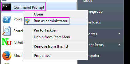

  22. granadacoder New Member
    Joined:
    Jan 20, 2014
    Messages:
    4 (0.01/day)
    Thanks Received:
    0
    As per my previous hint, run a cmd window IN ADMINISTRATOR MODE, and then you can see the results of the .bat file.
    See the screen shot attached. Then use the "cd" command to go to the directory where the .bat file is, and then type in the .bat file name to run it (and see results in the command-window). command_prompt_admin.png
    Make sure all paths in the .bat file point to an existing directory. (Open the .bat file in notepad to view).
