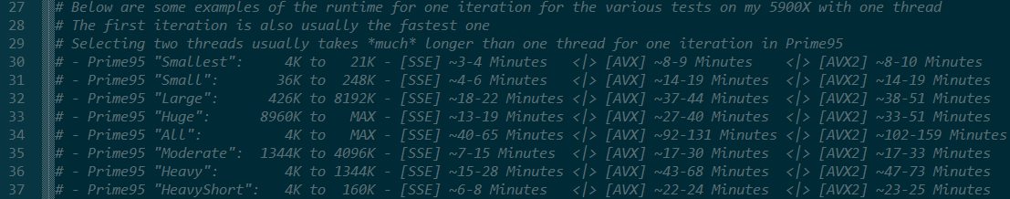

The default corecycler config is fine for a ballpark estimate of stability. I was a little harsh in my previous post. If all the cores can pass 5-10 iterations each, then it's fine to use that as a baseline.
After that you can go to a wider range of FFTs. Just make sure you adjust the iteration time to be appropriate for your choice of FFT. All FFT is very time-consuming, but it's hard to beat if you have the time for it. Otherwise, Heavy (30min) and HeavyShort (10min) seem to be recommended and seem to cover a good range, they're in the config file.
Better to focus on one or two cores at a time, lest you want a wack journey that looks like this (not mine):

Just chiming in here with an endorsement for useful software from Mussels' original post to help tune your 5800x.
The core cycler utility is really nice for ironing out any lingering "stability" issues that might be hiding from you. It's customizable (via a well-documented ini file) and it will tell you which cores had errors. I set mine up to cycle through each core for a long time. I left, did stuff outside the house, came back and hit ctrl+C to kill the script and it spit out a message that I had errors on cores 1 and 3. I backed off my curve offsets by 2 in each core and reran without errors.
This is a lot better than (but not necessarily a substitute for) setting a custom filter in the Windows Event Viewer and waiting for a WHEA error (which might never happen).
Obviously,I had nice soft errors in my Prime95 runs. You could get a more catastrophic error and black screen reboot. In this case, you wouldn't get to see the errors spit out by core cycler and you'd have to check event viewer for the APIC ID when you get back into Windows.

Honestly i'd forgotten to use corecycler after my latest rounds of tweaking - Mattferris reminded me
Core 3 is my highest clocking one that windows prefers a lot, kinda logical it wants more juice
Brainfart time: BIOS counts from 0, is this 3 the BIOS 3, or would it be BIOS 2 (since 1 is 0?)
mattferris
Nov 3, 2021
10 (0.02/day)
It’s 3 in your BIOS. Core cycled counts from 0
