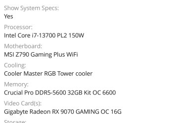

Which brand of card?
I'm also on MSI (Z690 Tomahawk). My 9070XT is an ASUS PRIME.
The Gigabyte 9070 OC
I see I have not updated my system specs here with the GSkill DDR5-6800 96 GB kit.
