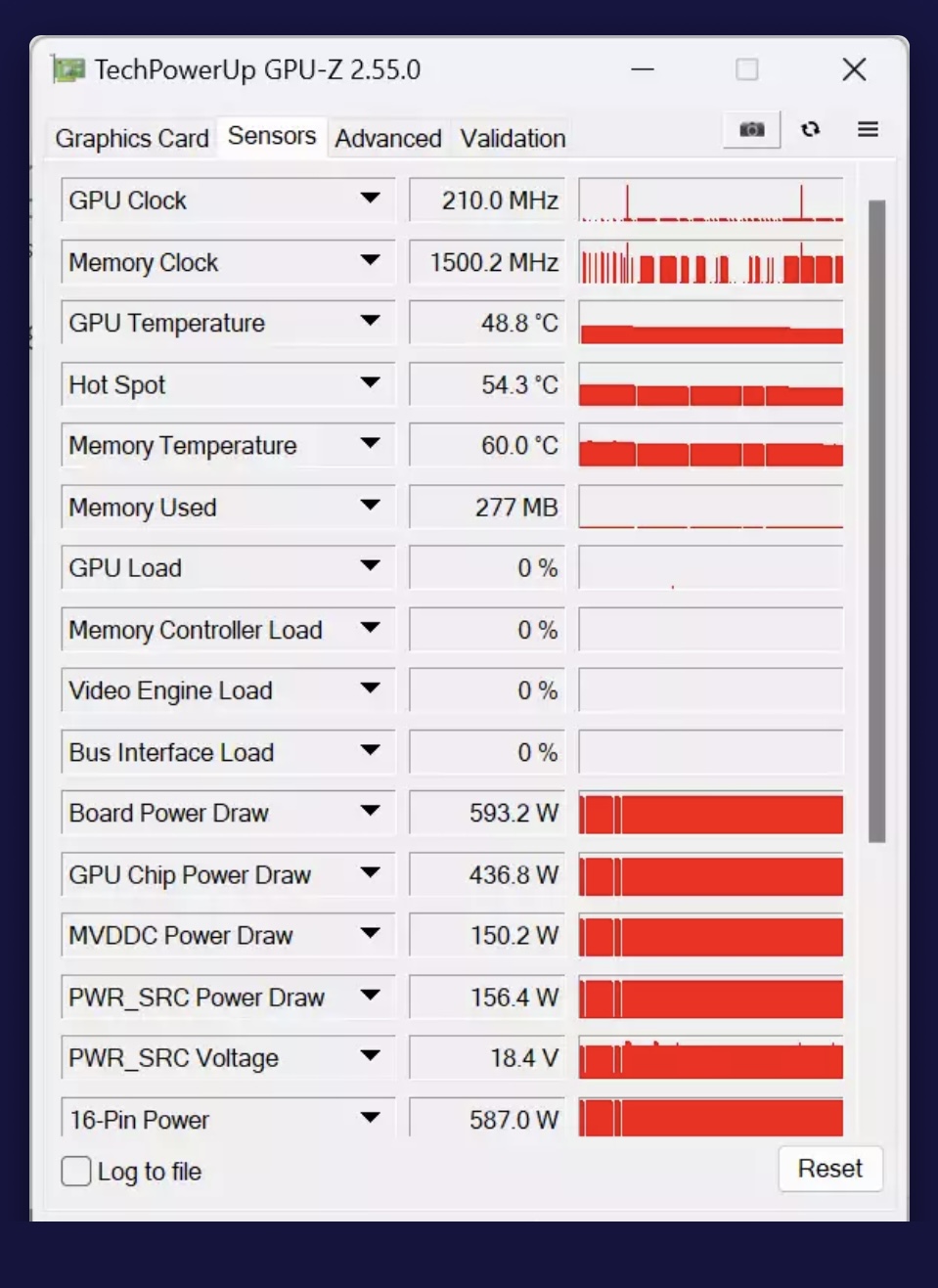

I bought the new Acer Predator Helios 18 with an RTX 4080 for my 9 month deployment to Lithuania. Laptops been working great up until I got here about 2 days ago. Plugged into the wall and the laptop says it’s stuck at 593w, 100% gpu usage, and 210mhz clock speed. If I switch to Nvidia GPU only it is able to show a display on the screen and I can use the laptop as I normally would with a little bit of lag and stutter when watching a video on YouTube. but as soon as i load into a game it locks at 5 fps and won’t move from 210 mhz. It also says it pulling 593w. I contacted Acer and they said I would have to ship and pay for the laptop since I’m in Lithuania even though it was purchased in the United States and I’m only here for deployment.
  • I have done clean installs of newest graphics drivers and OEM driver from acer website using DDU in safe mode.
  • I have factory reset the laptop and the installed a fresh copy of windows 11 with usb, figured out out to install without internet and then installed all OEM driver from the manufacturers website from a usb stick while in offline mode
  • I have force-reset the bios by holding down the power button for about 1 minute and removing cmos and battery plug
    guys please anything would help, otherwise I’m gonna have to pay a fortune to send this thing back to the states to get repaired by acer

Jeez, that's a weird one.
I know you made a fresh install so it probably rules out malware, but do this check:
Under Win11 Task Manager you can view GPU usage (hidden by default, you have to add column) per process.
See if there isn't any thing actually using the GPU, eg:
Is it generating heat ? 593W is massive (seems even impossible on a laptop).
Do you think the driver just *thinks* it's pulling 593W or is it actually pulling that much ?
EDIT: Well, the driver claims 0% GPU use, so it's probably broken power measurement. Sorry I don't know what else you can try.

unclewebb
Jun 1, 2008
6,675 (1.19/day)
It looks like the GPU power consumption is not being reported correctly. If the GPU was actually pulling 436W, it would not be running at 49°C.
GPU Load shows 0%, not 100%. The GPU Clock is at 210 MHz which is where it should be when the GPU is idle.

Thank you for your time to respond i appreciate it.
sorry I took this screen shot today in gpuz after the fresh install of windows11. Yesterday in the predator sense software if was showing 100% usage at idle.
