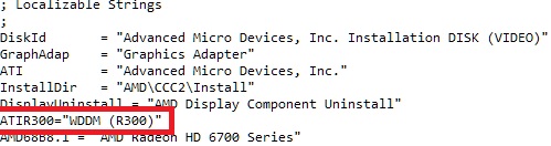

Just looking through the Catalyst 13.10 beta v2 C8162870.inf; only refers to R300 WDDM support at this time.
Example:
