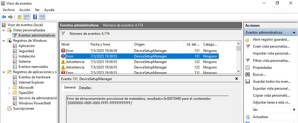

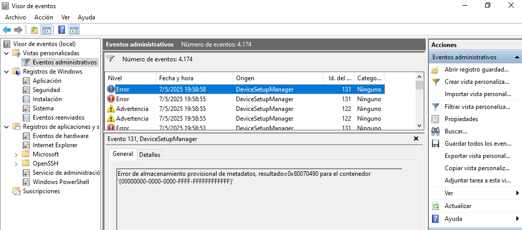

Thanks for your reply.
What I did was:
-flash the BIOS (version 000137) in safe mode,
-uninstall drivers in safe mode with the DDU version you sent me,
-select the option you suggested,
-install the Adrenaline 25.3.1 driver, and I got exactly the same result.
When the installation bar reaches 70%, the screen flashes, but I get the error.
In device manager, the GPU name appears without a yellow triangle and without code error 43.
I took screenshots of the event viewer showing two of the errors during installation that might help.I don't know what else to do, and I apologize for the inconvenience. I'll try installing the video card in my brother's computer as soon as I visit him and see what happens. And if not, I don't know.

Do you have a spare os drive to try?(clean os)
I wonder if a switcheroo was done with the pcb, like you got a challenger d card and not a phantom underneath (shady people) you can try the challenger files. If it works then problem solved.
If it doesn't respond you might have received a faulty card and at that rate you should consider a rx6600 brand new in box.
Being a rx 5500xt, you may not find a shop that can justify the money of repairing that card, you can enquire northridgefix on their website about it though.
