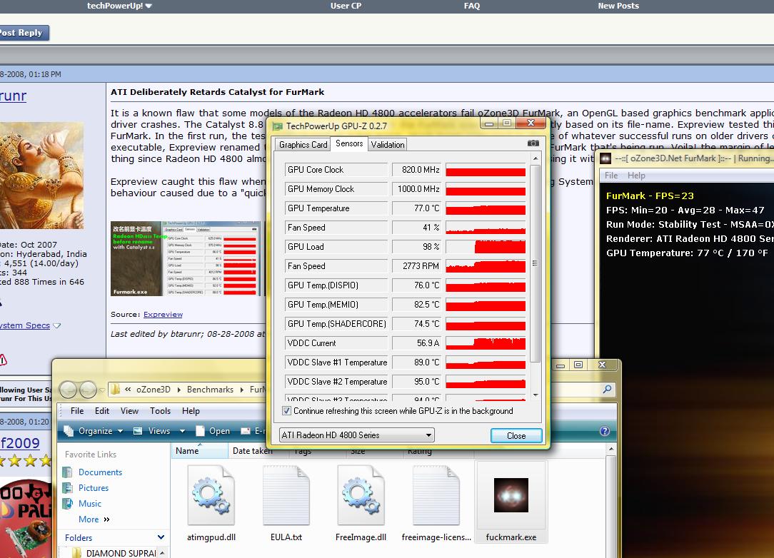

From the looks of things it appears that when I trick Furmark into believe it's using a nvidia card using a nvidia card's vendor and device ID:
-the vrm temps are lower
-GPU VRM is 12.2A lower
Now can we honestly believe that this is only related to how the 4870 is manufactured?
What's your point? Under Nvidia ID performance is significantly lower too, thus everything else is lower too.
TBH are you trying to make a point based on what? You tricked the benchmark to think it was a Nvidia card and you didn't expect something strange to happen? For instance, because the benchmark thinks is a NVidia card, probably isn't loading all the shaders because Nvidia cards don't have 5 ALUs per SP... :shadedshu

An easier way to answer it is to post results of a nvidia card (9800 GTX/GTX+, 260/280) and compare the results of the gpu temps, vrm temps and vrm amps.
I didn't do this to compare scores but to see if a difference was found in temps/amps.

Aren't you using the same card to emulate / "trick" FM to seeing a NVIDIA card? As W1z said there's a loss of ~10% score, as also amperage/VRM Temps.
I didn't know that a 4800 series was suppose to give the same score when the ID is changed to another. I see your point of view on this. However, I do not believe that the scores are suppose to be the same. However, I am curious as to what a 9800 or 260 GTX results temps/amp/etc would be when using furmark. Do you (or anyone else) mind posting them?
No, scores are not supposed to be the same, as I said probably there are many ALUs sitting idle. But, it doesn't matter. You don't seem to understand that when the card is not stressed under 100% load, the card requires less amperage, will consume less, heat less and even maybe require less voltage.
When disabled or when at idle the SPs act like resistances. High resistances when at idle and almost infinite resistance when totally disabled (I think only GT200 GPU can do this right now though, not sure). Now when voltage is constant (as is the case) the higher the resistance the smaller the amperage it will be.

So are they gonna try this on other boards aswell, because remember powercolor is having a rough time with their New line of boards.
It is a known flaw that some models of the Radeon HD 4800 accelerators fail oZone3D FurMark, an OpenGL based graphics benchmark application that has found to stress Radeon HD 4800 series far enough to result in over-heating, artifacts or even driver crashes. The Catalyst 8.8 drivers have found to treat the FurMark executable differently based on its file-name. Expreview tested this hypothesis by benchmarking a reference design HD 4850 board using Catalyst 8.8 driver, with two runs of FurMark. In the first run, the test was cleared at a low score, much lower compared to those of whatever successful runs on older drivers could churn out. Suspecting that the driver could be using some sort of internal profile specific to the FurMark executable, Expreview renamed the furmark.exe file, thereby not letting the driver know it's FurMark that's being run. Voila! the margin of lead the renamed FurMark executable gave over "furmark.exe" shows the driver to behave differently. A shady thing since Radeon HD 4800 almost became infamous for failing at FurMark, and at least passing it with a low score seemed better than failing at it altogether.
Expreview caught this flaw when testing the PowerColor Radeon HD 4870 Professional Cooling System (PCS+) when odd behaviour with the newer driver was noted. Successive BIOS releases didn't fix the issue, in fact, it only got worse with erratic fan behaviour caused due to a "quick-fix" BIOS PowerColor issued (covered here).
Source: Expreview

I see that all the long fraustrated nv boys who bought the overpriced GTX200 series are crawling out of the woodwork to celebrate.
It is amusing to see all the nv girls are having orgasm at the same time because a shady software and a shady website.
Anyway, I ran a test because of this "news":
My setup:
An overclocked 4870 running at 820/1000 using stock cooler
Furmark 1.4.0
Windows Vista Sp1
after running two tests for 1000 seconds, i took two image.
The first image was before the name change.
The second image was after "FurMark.exe" changed to "fuckmark.exe"
As you can see, the temperaure, the load, the VDDC current remain almost the same.
Also notice that the fan is even not spinning at half of the max speed.
so much for the "overheat"
So much for the "ATI Deliberately Retards Catalyst for FurMark" :laugh:
cheers:roll:

@bangmal: More number of people have verified this than you disproved it. You've not even shown which catalyst driver you use.

@btarunr, people do not report when their cards are working perfect. I admit, I have too much time tonight :p
46,371 (7.67/day)
They don't, but even when a handful of them do, it becomes a cause for concern. Especially when websites report this flaw and publish it. It's a known and verified fact that PowerColor HD 4870 PCS fails FurMark more times than it passes it, and that successive BIOS didn't fix it, at reference fan speeds the card can't take those temperatures, and so Catalyst 8.8 turns down performance.
bangmal
Aug 29, 2008
20 (0.00/day)
PowerColor HD 4870 PCS is using a very different cooler, i guess that is the problem.
I was using a GTX 260, overclocked at 720/1440/1200, it gets a significant lower score than a stock 4850 at furmark, does it mean nvidia deliberately turns down performance on furmark too?
It looks to me it is nothing more than a bug in the furmark, ATI fixes it in the driver update, thats all. Some people, especially the nv fanboys are making a mountain out of a mole hill.
46,371 (7.67/day)
We're not comparing GTX 260 to HD 4850 here, we're comparing the same card performing differently with different drivers on a benchmark, more so, performing differently with the same driver with the application renamed. Don't make pointless accusations without looking at sources, it's not just Expreview, several sources I talked to point to the same thing. The mountain is because that's a significant performance hit just to let the card sail through.
