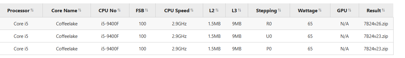

  • Updated BIOS to the latest version available from MSI

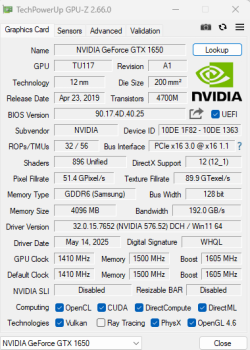

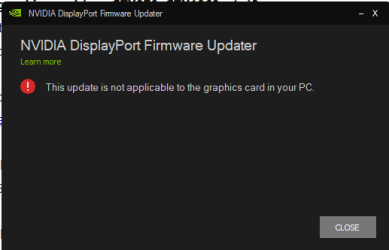

  • Followed NVIDIA’s firmware update instructions, but the firmware tool reports no compatible firmware found for my GTX 1650

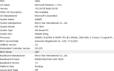

While using UEFI mode and booted into Windows 11, the BIOS displays a message saying "No driver found" under the iGPU section — not sure if it's relevant since the i5-9400F lacks integrated graphics.

Looking online, there does appear to be some people who have hacked GOP updates to their Turing based graphics cards so this is likely a VBIOS issue over at the win-raid forums - I'd be more inclined to contact info@galaxytech.com first and see if they have an update / fix available.
Really another modern (well, at least less than 10 years old) graphics card to test with would be handy.
UEFI support is unlikely to be guaranteed on anything older than Nvidia Kepler or ATI GCN cards.
Even then, for example, cards up to Pascal (GTX 1000 series) still got some fixes to their implementation.

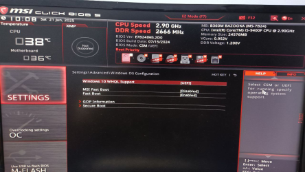

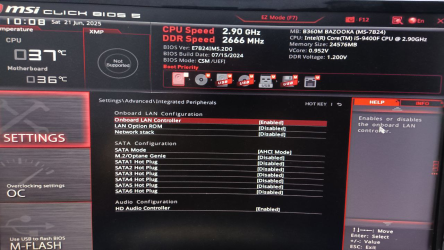

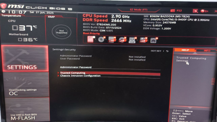

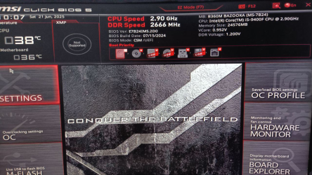

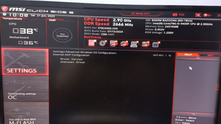

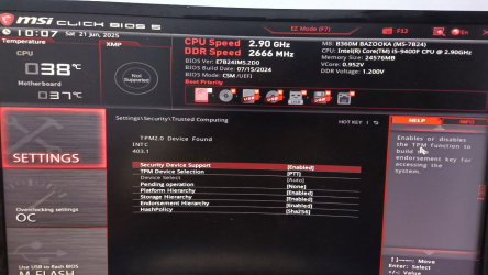

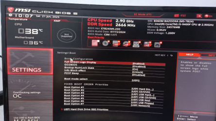

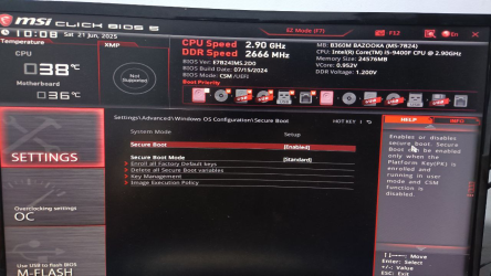

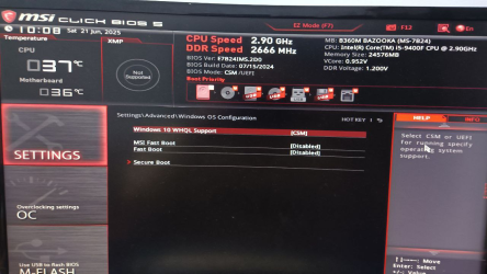

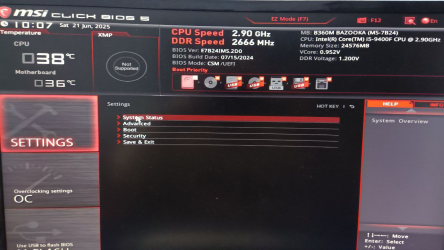

Here’s the current setup on my BIOS: I’ve set it to UEFI mode, but under Settings > Advanced > Windows OS Configuration, it’s still showing CSM as enabled. I think that’s why, even though Secure Boot is enabled in the BIOS, Windows still shows it as off.
Also, as I mentioned earlier, the iGPU is showing up as “unknown driver,” not sure if that’s related or just a separate issue.
Oh, and for what it’s worth, my drive is already using GPT partitioning.
One more thing I noticed—when CSM is enabled, the GOP Information doesn’t show up in the BIOS. It only becomes accessible when the system is in full UEFI mode. Not sure if that’s relevant, but figured I’d mention it just in case.

Technically I'm not sure if the GOP message 'unknown driver' is technically referring to the IGP (missing in this case) or the BIOS literally saying it can't figure out what the GOP software on the graphics card is.

Did you ignore where HDMI was mentioned instead of Displayport?
Use a HDMI cable to connect to the Monitor.

Hey there!
Looks like I’ve been away from this forum for quite a while—work’s been keeping me super busy.
Anyway, I finally had a chance to try your suggestion about flashing an older BIOS version using the support page from MSI (https://id.msi.com/Motherboard/B360M-BAZOOKA/support#cpu). I tried going back to the version shown in image 1, but ran into an issue: that version doesn’t seem to have the “Windows 10 WHQL support” setting, which is needed to enable UEFI mode for Secure Boot. So, Secure Boot can’t be activated with that older BIOS version.
At this point, I’m honestly starting to suspect it might just be a hardware defect or some other flaw with the product. Feels like there’s no fix that really works here.
