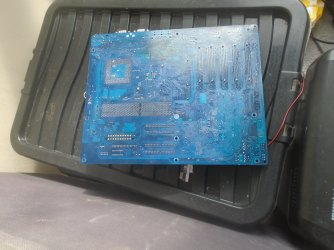

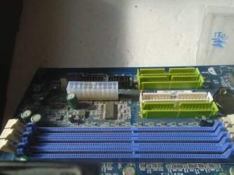

*SNIP*​

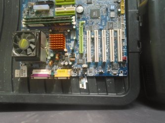

@Bill_Bright 2nd pic attached, ATX connector, that 5V pin doesnt look happy one bit!
@Greenslade Would it be possible to get clearer pics of the 20 pin ATX connector from both sides? It may be just dust but the discoloration makes me lean towards heat stress in the area.
Here it is it looks like dirt

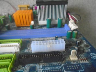

What do think of the ATX connector i think that is just dirt after all the there was no burning smell from the PSU.

Has the mobo not been used in a very long time? If so, the dust buildup may be the cause of the burning smell. I've had computers and printers make burning smells if they have not been turned on in years.
HOWEVER, those smells typically go away after around an hour of usage. If they persist, I'd start looking for other problems.
I have only used it a few times in the last few years.I have used the blower to get dust off a couple of days ago ,but been a bit scared to try it since then.What is your view about ATX connector it does look a bit dirty ,but the snell was coming from the cpu area.
I turned it off as soon as i smelt the burning snell.
I'd just fire it up and see how it runs.

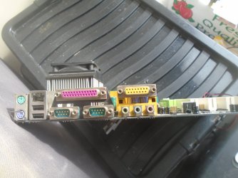

Looking at your pics, i see the 2 and 3 pics show the 20 pin has gotten the plastic on the front hot enough to discolor and the 4th and 5th pin group of that 20 on the reverse, back, side of the board show the heat also. Did you use case stand offs,, or was this on wood/cardboard?!?
it was just placed on this LIAN LI motherboard try.Is there anything i can do to resolve the issue?I did not screw it down.I did make this I/O SHIELD for it I suppose because it was not screwed down to the tray it might have moved to one of the stand offs on the board and shorted it that way.I will test on a box from now on.

Seems like a lot of work for such an old motherboard
Yeah, all I am really seeing is a lot of dirt/dust build. Some discoloration (yellowing) is normal over time. If dark brown or black, I might be concerned.
