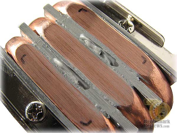

  10. erocker
    erocker Senior Moderator Staff Member
    Joined:
    Jul 19, 2006
    Messages:
    42,240 (10.42/day)
    Thanks Received:
    18,209
    What method did you use to apply thermal paste to the Xigmatek?
    After much testing the method in the pics below give the best results. First fill in the gaps with thermal paste, then two lines across the aluminum part.
    10 Year Member at TPU

    I agree with this assessment. The thermal paste application is critical with these exposed heatpipe designs. I like the example given above. I used a slighty different method on mine. Filled the gaps with compound but instead of applying the compound on the aluminum part I actually spread a very thin layer with a razor blade down the entire length of all 3 heat pipes (basically covering the copper surfaces completely.
    I have not tried the other method so I can't say for sure which would work better. However, what I can say is if you just put a blob on the CPU heat spreader and expect it to spread out nicely as it does with a flat heatsink bottom you are going to lose a bunch of compound up the crevices and it will not travel to the extremities of the CPU. That would leave areas of the CPU not contacting the heatsink.
    Did you examine how well the thermal paste spread when you removed it the first time? If you do decide to reseat using one of the above methods it would be good if you took a photo of the surface of the CPU right after you remove it so we can see how well it spread.
