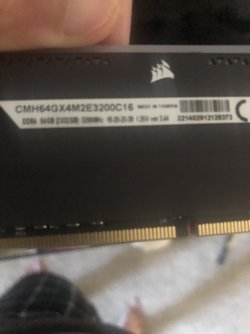

Hi,
Post an image of the back of the sticks so we can see info and the VER# or just look and post it.
Hi,
If ver# is 4.?? it's a good kit
If the ver# is 3.?? it's crap don't bother.
Hi,
Don't bother
You're lucky they work at all on xmp.
