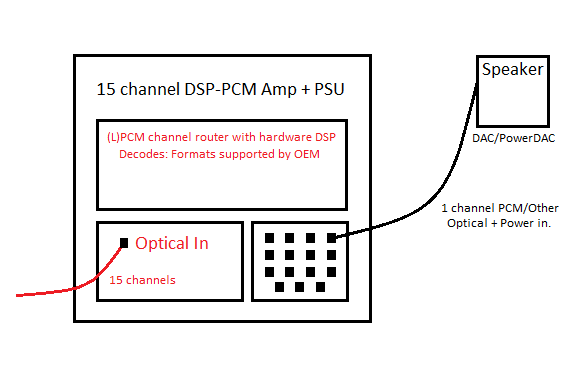

Here is my DMAS (Digitally Managed Audio System) design (lossless up to, into the speaker), for anyone interested. I am trying to eliminate additional components (cheaper, less THD THD-N, lower latency).

You can image the main unit of the DMAS as a PCM processor or SPU (sound processor unit), with-without DTS-Dolby-Other PCM enhancements.

Example speaker PowerDAC, however with a DMAS the PowerDAC is built into the speaker unit, and is mono. Speakers should be the only point consumers can change audio quality.
All speakers should ideally use some sort of standard, or detection could be added at the DSP unit, alternatively use changeable PSU's, similar to computers.

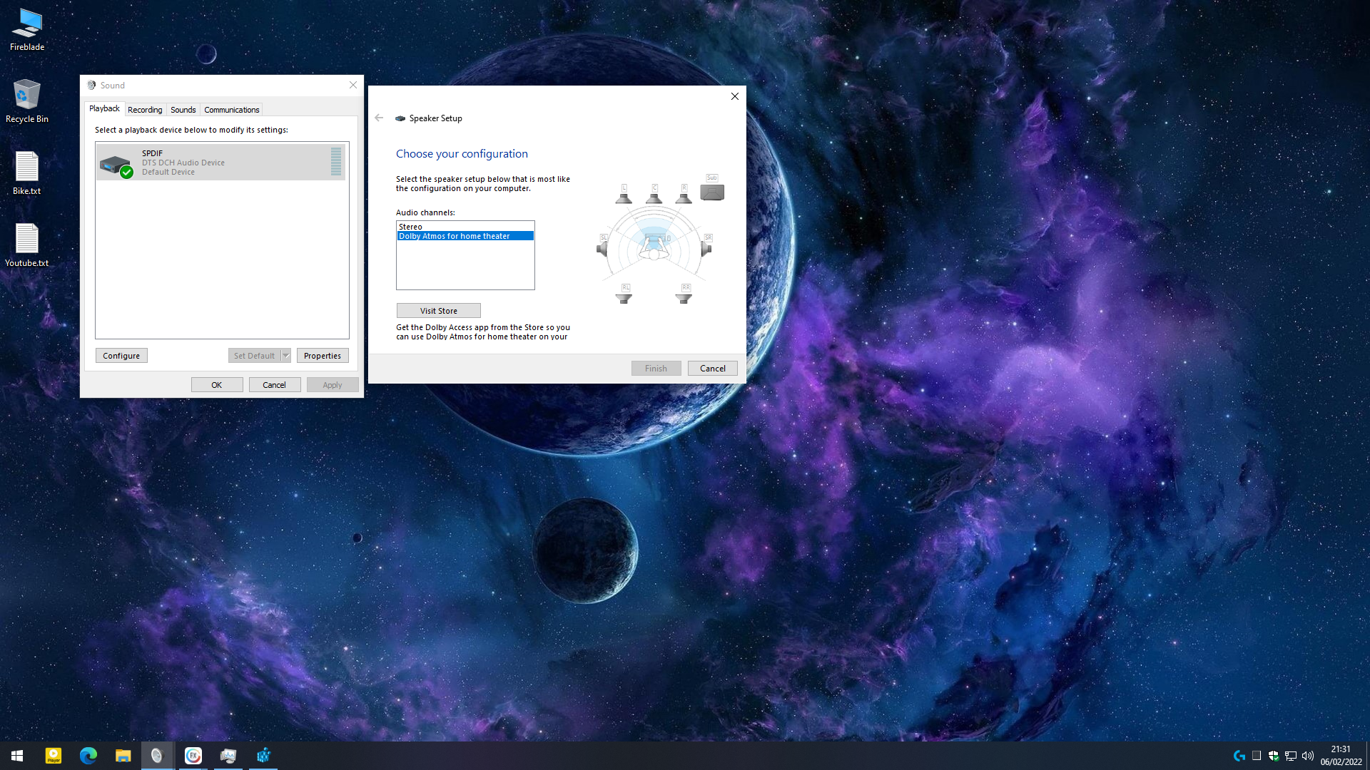

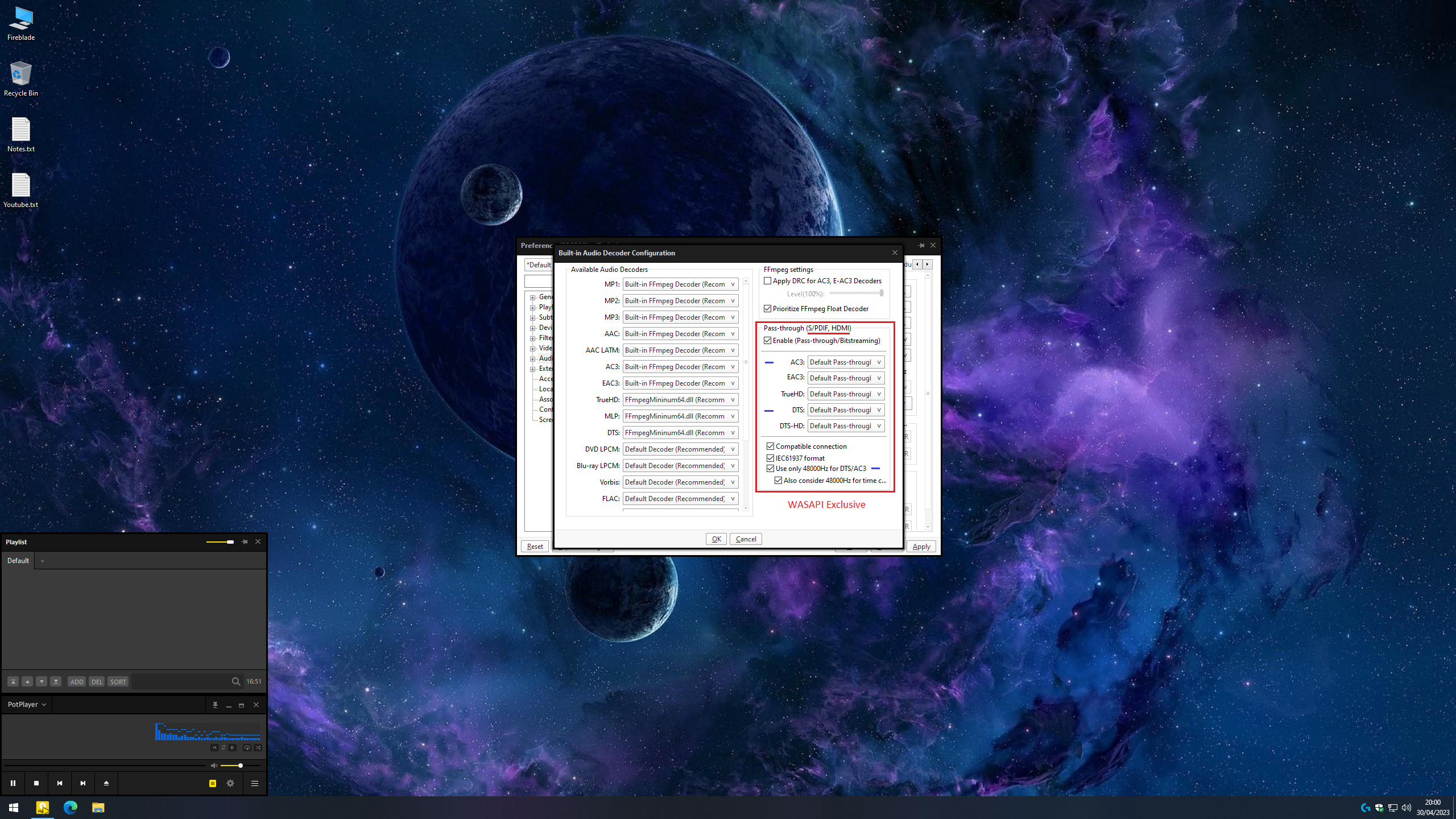

Also note with HDA (HDAUDIO), using Windows (W10), SPDIF can be configured in the same way as Speakers and HDMI (configuration button), and work with the same registry data.

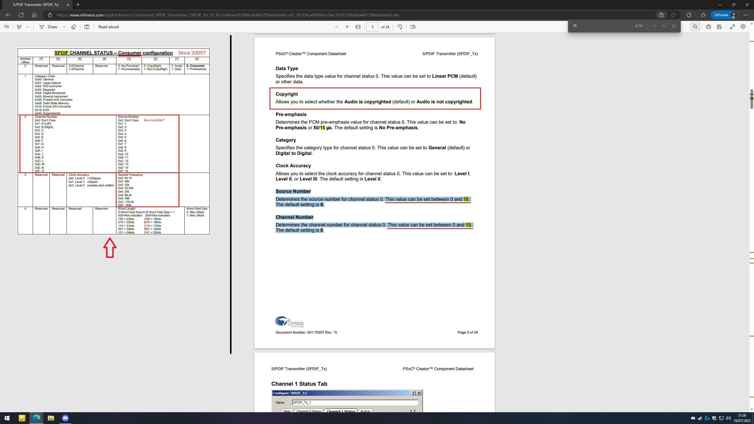

The 15 channel SPDIF transmitter listed in post 1 is programmable in terms of input and output channels (also 15, and don't care mode).
If I add formats to SPDIF (e.g. DTS-HD), and then convert form factor to HDMI, not only do the ticked formats and samples show, but also a 2 channel transmitter (as EDID).

DMAS main unit (sound processing unit + power supply) > DMAS optical audio cable (1 channel, speaker) > Speaker [PowerDAC].
Software amplifier via multicore CPU, 32 bit float (1528 dB) more than any physical amp, bitperfect-lossless.
24 bit ,144 dB input > DMAS, SPU | 32 bit float > additional processing, adds 24 dB > attenuation to 24 bit, 144 dB.
Note that the additional 24 dB did not add clipping or any kind of distortion, no where near 1528 dB.
Example mock cable, set or custom length.
