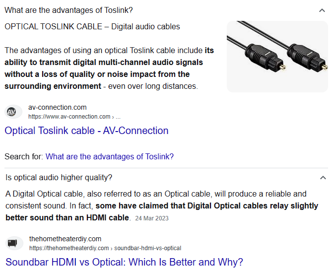

Nice to see, also to add your previous question, you can get DTS:X over optical if you use a HDMI to TOSLink converter (GPU as sound output), it will register as HDMI with form factor HDMI.
In my case the converter already came with the DTS-HD format support, but regardless I am using an EDID override driver for TOSLink formats and 6 channels.
The receiver also needs to support receiving the format via optical, where support for HDMI and SPDIF can differ.
As a side note, given balanced interface gain, there is almost no difference between 32bit analogue and 24bit optical with lossy encoder (both lossy in this case).
The clear winner would a lossless format or no compression when using multichannel optical, which is currently not available (hopefully soon).
