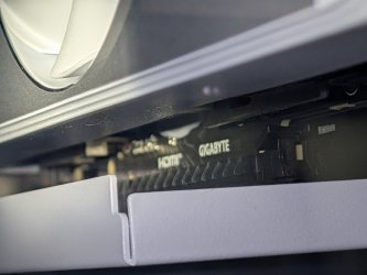

I just bought a Gigabyte graphics card about 2 weeks ago. 1 week shipping process and then this past week using the RTX 5080. I am just now learning of this leaking problem, so I check under the heatsink and boom some blob oozing out. I am very worried about this, for obvious reasons. . . . about 1500+ reasons. These things cost so much and to use the card for about a week then the gel leaking out. Will this cause problems if that gel leaks onto other parts or fry the card if it somehow leaks down into the connection slot? I have a vertical mounted Lian Li case with a riser cable. I am still fairly new to building my own rig and this is my first issue with products. First time using Gigabyte as well and this makes me never want to have any other product from them.

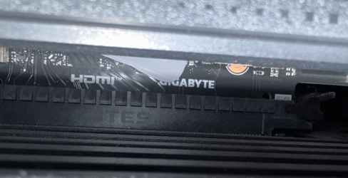

Same appears to be happening to mine, and it doesn’t even appear to be melted at all, just completely slipping out of position.
Mine looks very similar to yours, except in my case the thermal pad still seems to be holding it's orginal shape, it seems to have just completely slid down and has barely deformed at all.
TaLL - this happened only in one week?
I wonder if you could try to focus the photo on the leak, so that you can compare it well with future photos to see, how quickly it moves.
You can even still see the RAM packages outline on the gel. There is something seriously wrong with this stuff.

Legit 1 week. I bought the card April 19th and after shipping I got the card April 25th on a Friday. I installed the card the next day April 26th on Saturday. Then used it for the week of April 26th to May 3rd I noticed the gel coming out. Exactly 7 days. Some of those days I actually didn't even use my PC. The past couple of days since I noticed the leak, it hasn't grown. As I check like hourly while gaming. What I have read from others having this problem it seems most people are going to wait to see if temperatures start becoming an issue. I guess because Gigabyte isn't great with returns from what I understand. Idk because I haven't really dealt with them before.
