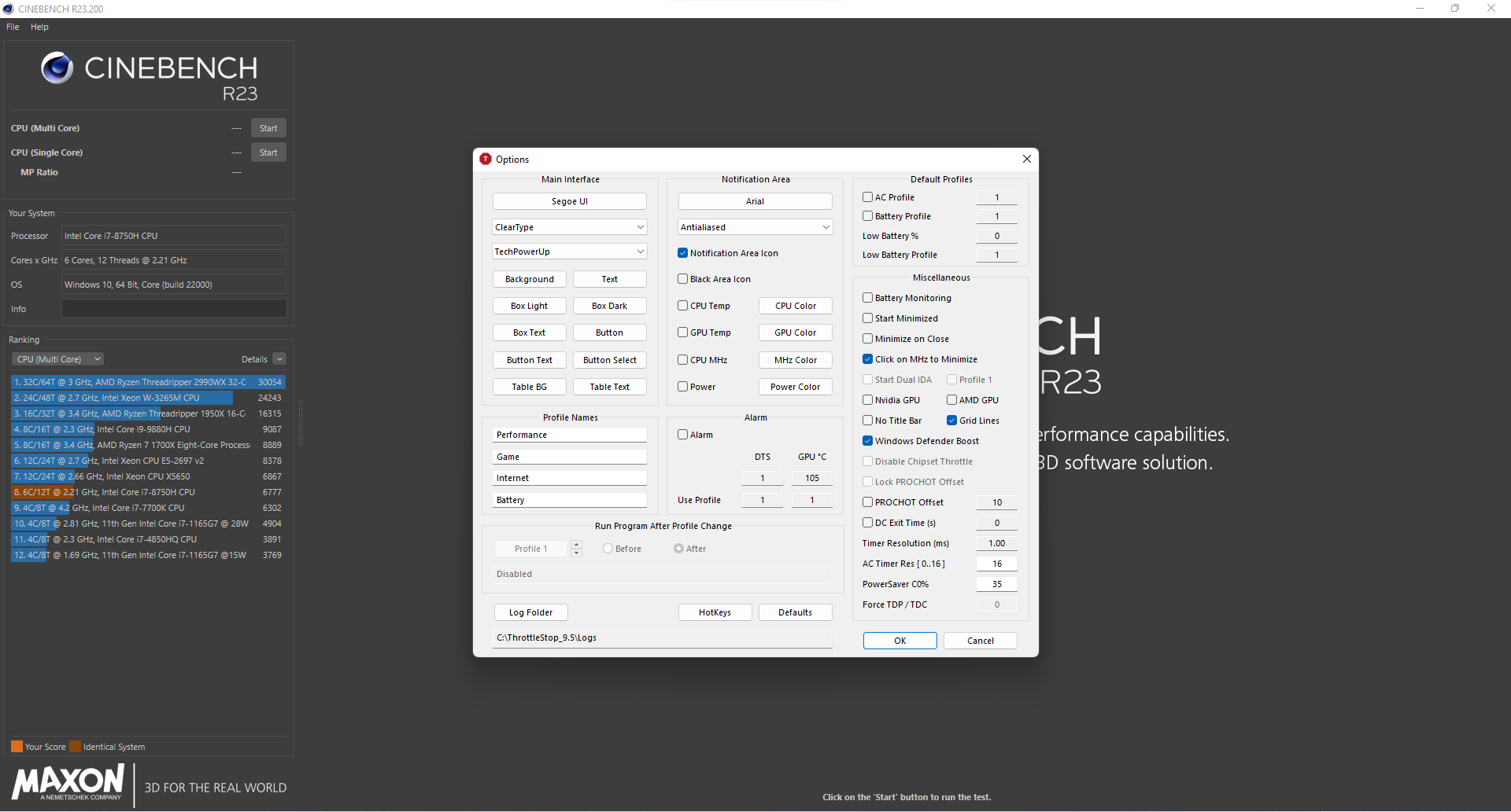

Please look over my logs and screenshots and advise if there is anything you can think of that might be causing this issue?

You have a power limit throttling problem. The MSR and MMIO power limits that ThrottleStop has access to are being ignored. There is a third set of turbo power limits controlled by an embedded controller (EC) that ThrottleStop does not have access to. It is likely these power limits are being set too low which is causing this problem. The CPU is being throttled down to its base frequency which is a multiplier of 22.00. If your laptop used to work properly then maybe an onboard sensor has failed and it is forcing your computer to run in low power mode.
Have a look in the Device Manager for either the Intel Dynamic Turning driver or the Intel Dynamic Platform and Thermal Framework driver. I would uninstall this driver and do whatever is necessary to make sure it is not re-installed after you reboot. Use Google to learn more about this issue.
I would also uninstall the Clevo Control Center software. You might need this software for fan control but to try and troubleshoot this problem, any software like this needs to be removed.
The Nvidia GPU being active might be what triggers low power mode. You could try uninstalling the Nvidia GPU driver. Just run the default Microsoft driver for testing purposes to see if this allows the CPU to go up to full power. You can also try installing the original Nvidia driver that has been tested with your laptop.
There might be an easy fix or if a sensor has gone bad, there might not be any practical fix. Your ThrottleStop settings are OK. The offset voltage and power limits are set correctly. ThrottleStop cannot be used to fix the throttling problem you are having.
Use ThrottleStop 9.5

If that nets you no real changes, have a look at these settings and give them a try (OTHER THAN the undervolt, stick to YOUR predetermined voltage). You may need to update to Throttle Stop 9.5 to match things. This is the 'Performance' profile I use and has no kind of throttling on Max Turbo for my 1720. If it works for you, then you can limit things on other profiles as you see fit.
Additionally, I believe your BIOS may be fully unlocked via this tool (InsydeH2OUVE_x86_WINx64_200.00.01.00) - http://en.inspur.com/eportal/fileDi...spur TS860M5/TS860M5_BIOS_4.0.04_20190424.zip
You'll see 'Setup Menu Insyde Full Show' is set to "Hide". Change to "Full" and options should appear. If you save and boot to BIOS they should be viewable/selectable.
It is how I unlocked my 1720 BIOS and can change PL levels, and about 1000 other settings from Windows or BIOS. It seems to work either way, requiring a reboot if in Windows. If this works for you let me know. It was shared to me from another PowerSpec user.

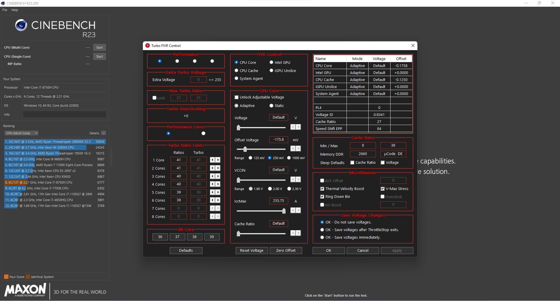

Hi everyone, can I get some suggestions to undervolt my 8750H? Here are the details,
• Alienware m15
• Windows 11
• i7-8750H
• GTX 1070 Max-Q
• Kingpin KPx thermal paste
Tested with Cinebench R23 and monitored with ThrottleStop 9.5 (default settings but "Log File" turned on).
  • Log.txt

In Windows 11 you need to disable the virtualization settings to allow ThrottleStop to access the CPU voltage control register. I just talked about this issue yesterday.
After you get that problem fixed, you should be able to undervolt the cache approximately -125 mV and the core approximately -175 mV. Use Cinebench R23 for testing purposes. Follow the advice previously posted in this thread, in all of the other TechPowerUp ThrottleStop threads and the 101 YouTube videos that are available.

naufalkharits
Aug 13, 2022
6 (0.02/day)
Taking my first undervolting, quite impressed with the results (performance & temp). Here are the details of what I did,
• Disabled virtualisation
• Core set to -175.8 mV
• Cache set to -125 mV
Not much changed, I haven't read much yet on other threads, prefer safety and stability first for now.
Thank you for the advice.

unclewebb
Jun 1, 2008
6,082 (1.11/day)
Your undervolt is working correctly.
The only problem now is your Alienware cooling system appears to be inadequate. Have you ever disassembled your laptop to clean it out? Blowing the dust bunnies out of the heatsinks might solve your overheating issues. If you are still seeing temperatures hit 100°C during Cinebench then I would also replace the thermal paste.
Dell is known for using barely adequate heatsinks. With a high priced Alienware laptop, I would hope that the heatsink, when properly cleaned, would be a little above barely adequate. Hopefully it just needs servicing but it is possible that this is as good as it gets.

Testing-3
I think I found the sweet spot,
• PROCHOT Offset set to 10
• Locked MMIO
• Power Limit 4 set to 0
Very impressed with the results, by doing this the temp even didn't reach 95℃, and the performance was only reduced by less than 5%.
So far what I did,
• IccMax (core & cache) set to max
• Locked MMIO
I'll update with gaming test.
If Honeywell PTM7950 TIM doesn't work out for you then your cooling system is flawed like @unclewebb mentioned previously!
My cinebench R23 score and max temp 83°C considering 90% humidity and 30°C ambient temperature using Honeywell PTM7950 below View attachment 258151
Hard to find that thing you mentioned in my country, and I'm too lazy to order from foreign countries, you know tax, cc, and such.
  • Log_Testing 2.txt
  • Log_Testing 3.txt
