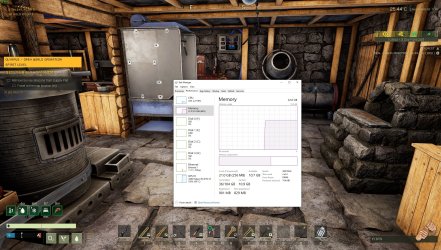

Im glad you can! but once you start playing more intensive games or even free games like Marvel Rivals or Icarus they use more then 16GB of RAM. Once you hit this RAM limit you will get issues like what he is talking about or worse the game just freezes and crashes.
Below is a quick picture to show how much RAM Icarus can use.
Marvel Rivals just hits over 16GB. I can screen shot it for you if you want!
The amount of RAM is not the issue. 16GB is fine. Yes games can use more, but just because a game can use 20GB RAM does not mean it requires 20GB RAM.

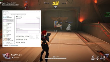

I can tell you for a fact it does not! maybe unless you have your settings on real low? But I can tell you now it doesnt. At first I thought it would run perfectly fine on my second PC that did only have 16GB of RAM, the game launched, I started a match but it was very choppy and laggy, and within a few mins the game had frozen and then crashed, I was thinking WHY! I have a RTX 4060 and its at 1080P but then I noticed that the RAM was maxed out! So I bought another 2 Sticks of RAM and increased my second rig to 32GB same as my main Rig which ran the game perfectly fine even at 1440P and yep as I thought! it fixed the issue and it was indeed using just over 16GB of RAM, 16.3GB to be exact but that was enough for the game to freeze and crash.
Below is a screen shot of my second rig in game with just Discord running in the background and you can see it is using over 16GB!

And that's why. Try doing that with a 5090 and its 32 GB VRAM, and 32 GB isn't enough. I've been constantly running into problems when my VRAM usage is high, had to extend the swap file to dodge the crashes ever since I bought mine.

Go to the Processes tab and take a screenshot, upload it here
