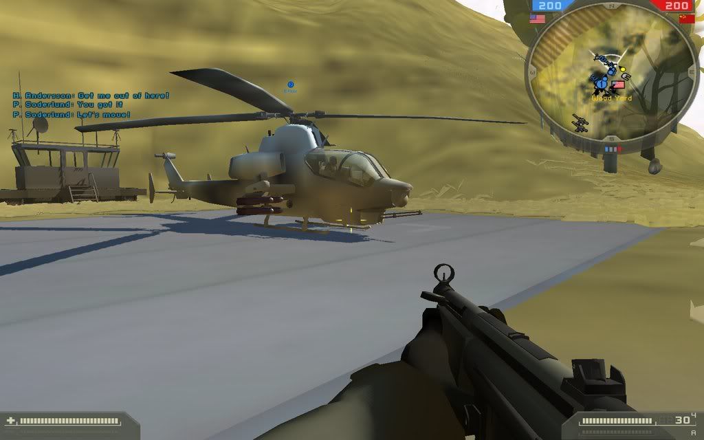

Here is a screenie for yas wtf this is with c/f enabled only started doing this today???
this is the same if i run 3d mark or any other game.
Does it with crossfire dissabled also
