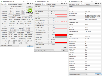

PS: I've attached a GPU-Z screenshot just in case it helps anyone.

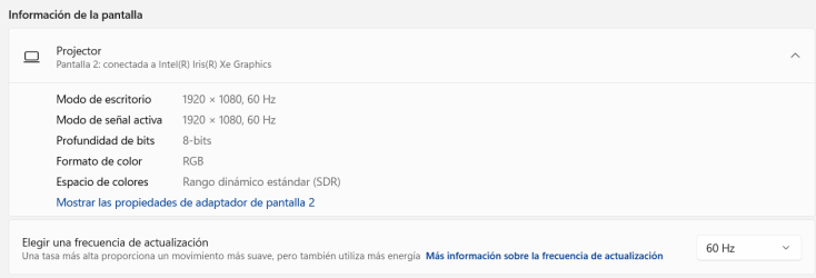

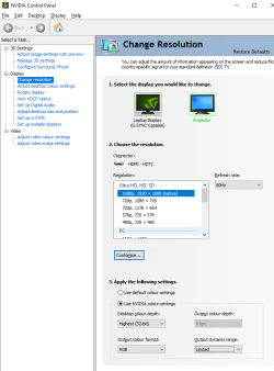

Software W10
I don't think this is a cable issue, since same cables worked before and do still work on other computers. Also drivers is not very likely, since I've the same issue when starting the machine on a different W10 partition which does not automatically update, and same issue even on LINUX (external drive boot).
Also, as stated at the first post, this Notebook is often connected and disconnected to different HDMI cables, which increases the chance of this being a hardware issue (but a rare one).
Regarding "my memory" I know for sure it is not the best LOL - And it could be that at some point I updated BIOS or GPU Firmware (not even sure how to do that), but I've tinkered around after my M2 system drive just quit working and I had to install everything from scratch again. But again, and this confirms my bad memory, I'm not sure if this was before or after the GPU issues (I think GPU was first). I could check if anyone thinks it can help to shed some light on this.
Regarding having no intel IGP I'm pretty sure it does not have it. It just has one GPU and everything runs on this one. However I'm not sure how to prove it and I could be wrong. The RTX is definitely the only one listed in the device manager or anywhere else I've tried. Also I know other people in the theatre bussines also have notebooks with just one graphics card - One of them is a Tech support guy from ISADORA who pointed out that I also could have only one GPU when I was asking for some support.
The 30m cable is a LOGILINK CHA0030 - It is ethernet based and is meant to be 4k-30Hz capable. Now I see it says "Comply with HDMI 1.4 High Speed with Ethernet". ANYWAY I do not need this cable to output 4K since I'm using only 1080 or 1200 projectors. When working at home on video edition I use a Dell 4K monitor, on its original short HDMI cable, which before was working on the HDMI port and now does not. But it works using the HAMA MiniDP-HDMI adapter. I actually thought my HDMI port was completely broken for a couple of months. Only last week I tried a short cable (a cheap one) to connect it to a 1080p projector, and it works fine. But the long cable does NOT work with that projector nor on an older TV I tested being on tour. It does not work on the HDMI Port, nor using the HAMA miniDP-HDMI adapter. The Hama adapter works when using other cables (the cheap short one and a 10m cable I've been using). Unfortunately I did not try the 10m cable on the HDMI output directly, since I still thought it was broken and now I'm elsewhere and don't have that cable anymore.

Hi again, here's some screenshots. I can only test with a 1080p projector. My 4k monitor is at home.
Projector connected with the short cable to HDMI out from my RTX-2070
* Normally I use default colour settings, but tried the other options, all seem to work fine.
* With the short cable I get the same when connecting through any of the miniDP ports with any of my two MiniDP-HDMI adapters
* SUMMARIZING: short cable works in any setup
Projector connected with 30m cable to HDMI out from my RTX-2070
NOT RECOGNIZED
Projector connected with 30m cable to HAMA MiniDP-HDMI out from my RTX-2070
NOT RECOGNIZED
Projector connected with 30m cable to no lable MiniDP-HDMI out from my RTX-2070
RECOGNIZED but very unstable. Looses signal every few seconds and if it stays a bit it shows pixel noise.
Projector connected with 30m cable to HDMI out from an ASUS VIVO-BOOK running an Intel Iris Xe IGP (on W11) I guess you get the spanish terms ;-)
* This proves that the cable is actually still working (and it has been working for at least a year on my RTX 2070)
So these are the pieces for the puzzle.
Thank you all so far.

What we're seeing there is that the projector only worked with limited color on the nvidia GPU
If it's not even recognising, theres nothing you can do. You need to use a different setup.
Oh i see Gsync is on the system, try disabling that entirely - and make sure none of the resolution scaling crap is enabled. There a known bug that makes multi monitor setups flicker a lot while thats present, but it should only last 5-10 seconds.
Gsync on the other hand, can increase the bandwidth sent over a connection and could be related, and it's something Intel cant do
