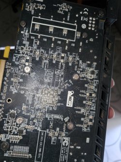

I have a 470d that was flashed to a 470 and I installed custom drivers and can't update to the latest one to play games. (DVI only)

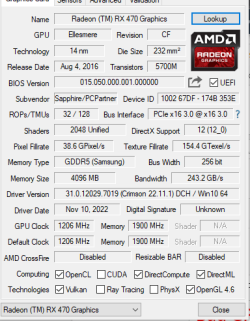

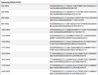

Can you get a gpu-z screenshot, then 1 of the Advanced Tab with Memory/Timings Selected please?
Try Radeon Pro For Enterprise
i tried clock patcher which seems to have worked for now but just incase.

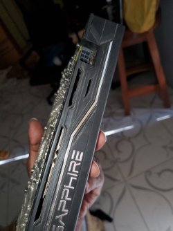

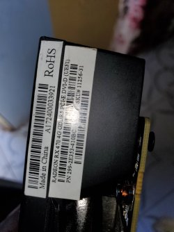

What heatsink is on the card, i noticed a sticker by the pcie blade is there a number on it?

Ok in your image there is a white sticker by the pcie blade, get a pic of it, get a pic of the gpu heatsink as well (PULL YOUR CARD OUT OF THE CASE)
idk what you're referring to here.
