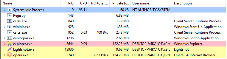

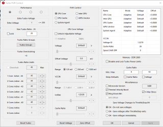

I've started noticing that when I go away from my laptop for 30-40 min and even shut the screen the idling temps can go up to 95 degrees.

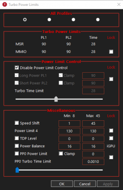

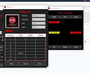

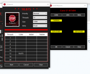

I've included some limitations and when they appear and all my settings so far, I also tried logging after gaming session because I suppose it can be useful but couldn't do it.
I've checked my laptop multiple times for any malware but I really couldn't find anything that can be suspicious, but nonetheless I posted my Task Manager screenshots and Process Hacker 2 screenshots
Only thing suspicious I see is winlogon.exe with different icon.
For the record right now I changed my settings to Powersaver in Throttle stop and it was at 77 degrees while I was writing this.
I forgot to include screenshot of my main screen
And another odd thing that I noticed is that my 9750h needs to be running at 2.60GHz but in performance mode it goes up to 4.1GHz

The main screen shows your CPU is reaching 100°C when power consumption is only 29.6 Watts. The 9750H has a 45W TDP rating that needs 80W or more so it can run fully loaded at full speed. That means your cooling is completely inadequate. When was the last time you opened up your laptop, cleaned it out and replaced the thermal paste? This is normal maintenance for performance oriented laptops.
2.60 GHz is the base frequency for a 9750H. Intel Turbo Boost can increase that to 4.00 GHz or more depending on how many cores are active. That is the normal operating speed for a 9750H as long as it is not overheating or power limit throttling. Fix your cooling problem so your CPU can run properly.

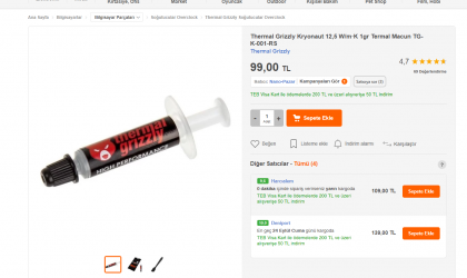

Avoid Thermal Grizzley at all costs. this paste damages CPU coolers/Dies and heat spreaders because they have batches that contain a lot small particles that cause scratching and pitting.
Mastergel Maker Nano or Gelid GC Extreme is also another good option

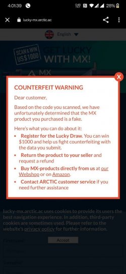

Just decided to scan my MX4 2019 and look what I got :D
Honestly this answers to a lot of questions
