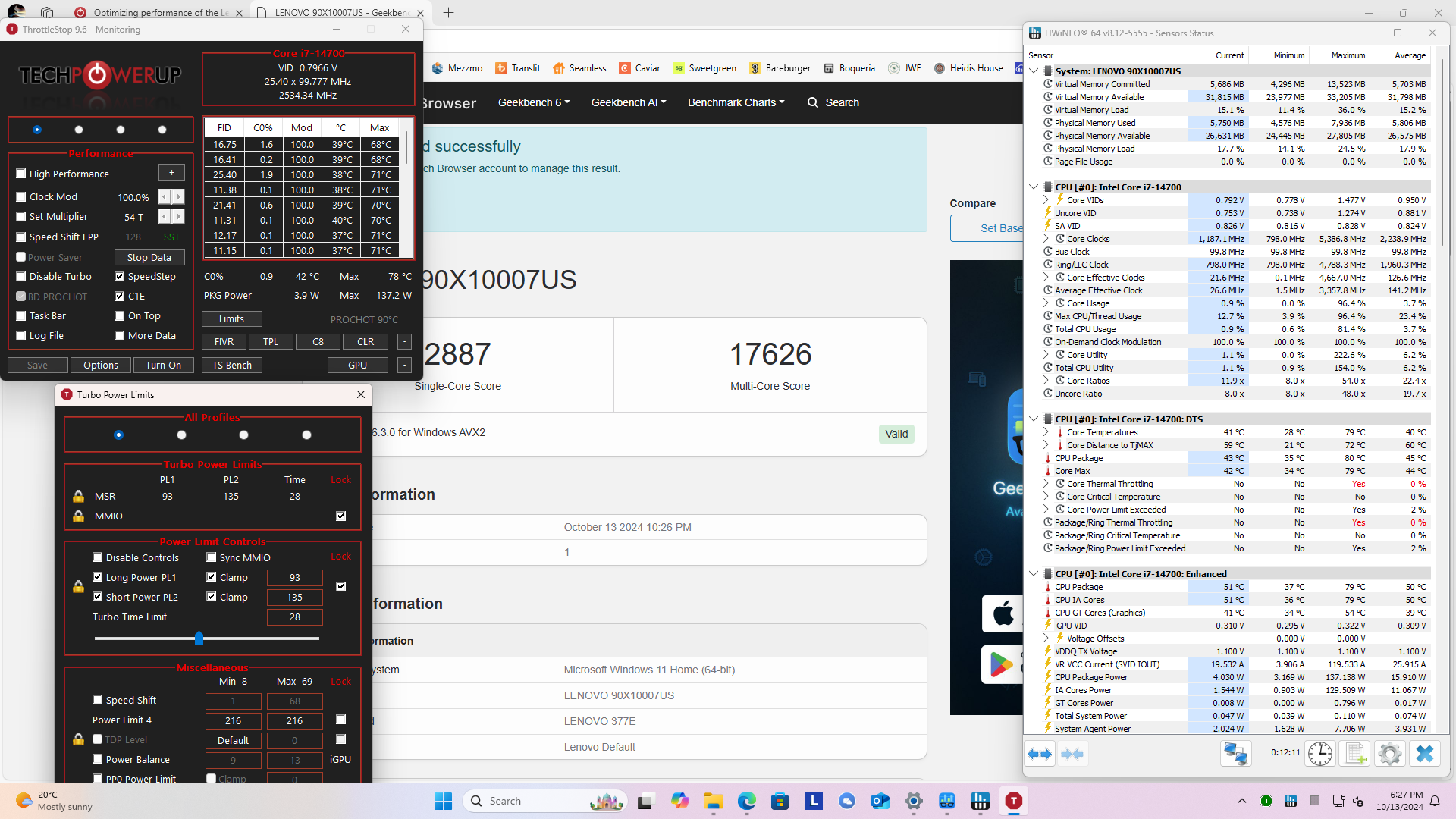

Tried your suggestions and it seems they are doing their job. Benchmark scores are now around what they are supposed to be with the negative of much higher CPU temps, as expected. Does it make sense to play around with Power plans (getting rid of "Lenovo" plan and switching to High Performance or Balanced) and getting rid of Lenovo's software (it restarts itself even after ending the task)? Also, to play around with Power Limit Controls and Miscellaneous in TS to get a more balanced performance/temperature ratio? Like setting PL1 to 93 and PL2 to 135 with a different Turbo Time Limit, etc.? Trying to understand what's possible with TS and my system.

Anything is possible. You can adjust the turbo power limits so your CPU does not get so hot or you can adjust the turbo power limits for maximum performance or anywhere in between. It is totally up to you.
Your screenshot shows a peak of 152.7W. If you want to limit your CPU to 135W, clear the Disable Controls box in the Power Limit Controls section of the TPL window. Check both Clamp boxes. This can help enforce the 135W power limit that PL1 and PL2 are presently set to. It looks like only one of the Clamp boxes is checked in your screenshot. The Short Power PL2 Clamp box should also be checked.
Your Cinebench score has gone from 16,269 to 23,370 which is a 43.6% increase. :eek:
Not bad when all you had to do was click a couple of boxes in ThrottleStop. I wish more people knew about the huge performance increases that are possible by increasing the power limits on the 65W non K CPUs. Everyone seems to think these CPUs are locked down but obviously they are not.

Tried to adjust Power Limit Controls (not sure if they needed to be Locked though) with good results. However, noticed that during CB test it still peaks at ~155W (while being clamped at 135). Am I missing a setting somewhere? Btw, is there a doc or a video to learn about the Miscellaneous controls in the same window? Would it be beneficial to learn them in my case?
