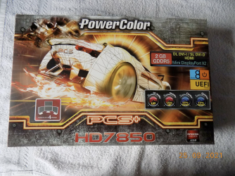

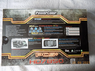

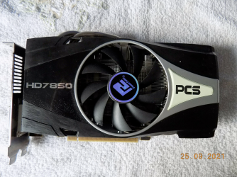

Should i buy the HD7850 £57 from CEX, with a 24 month Guarantee or this boxed one from ebay for £59 pounds.
PowerColor PCS+ Radeon HD7850 2GB Graphics Video Card
Model - AX7850 2GBBD5-2DHPPE
Supports up to 4 displays.
Removed from my own PC during upgrade, has been an excellent card.
I have stripped and cleaned inside and around the heatsink but the plastic shroud feels a little sticky, not that it should really bother you once installed.
Comes boxed with all original fittings.
Why is the plastic shroud sticky?he said it could be to do with cooking fumes from his kitchen as the door is allways open.It effects his remotes to he said.
£59 pounds.The thing with buying from CEX you never know what version of the card you will get.Which one should i go for, i like the idea having one with the box and accessories. I see he has reduced it by five pounds when i was thinking of buying it.The guy has acceted my offer so i will go for it.
Memory Size: 2 GB Memory Type: GDDR5
Connectors: DisplayPort, DVI-D, DVI-I, HDMI Features: Multiple Monitor Support, SLI/CrossFire Ready
Compatible Slot: PCI Express 3.0 x16 MPN: AX7850 2GBBD5-2DHPPE
Chipset/GPU Model: AMD Radeon HD 7850 Brand: PowerColor
Chipset Manufacturer: AMD EAN: 4715409181897
