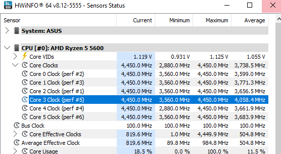

Also for the CPPC i dont think its working for me
CPPC ON. All perf Cores are 1
CPPC OFF.
So with CPPC Enabled is windows putting all work on 1 core or whats happening?
Don’t have a clue why all cores have #1 on the CPPC order. I think I never seen it before.
The concept of CPPC is that because not all cores can achieve the same frequency windows must know which are the best so on low/medium threaded tasks, including gaming, the CPU can achieve highest performance by loading those first.
In your case maybe the silicon quality is the same across all cores that’s why all are #1, or something else is going on. I can’t tell, as I said I never seen this before.
