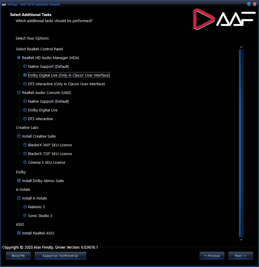

I did a quick search here and realized that the APO of Sound Blaster Connect doesn't really behave as expected when in conjunction with decoders (Dolby, DTS). So, for those who want to enjoy 5.1 surround sound both via the S / PDIF output and through the 3.5 mm jacks, I recommend that, when installing / reinstalling the mod, choose ONLY ONE of the enhancements available in this package. Sorry for not being able to provide adequate corrections, I don't have any surround sound system. I use headphones.

So you mean, we should deside to choose between DDL and DTS-C, when installing APO tool/driver ?
No. You must choose only one of the enhancements available in the package (Sound Blaster, A-Volute or Dolby Atmos).

Okay thanks for answer!
Do you meant only APO for Creative SB ... or there's the problem in APO for Realtek too?
p.e.
Dolby Digital Live ... and ... Dolby Atmos ... for Realtek HDA 1220 (S/PDIF, Analogue, HDMI) ?
I don't need A-Volute, but Realtek ASIO ( I activated it for installing) would be nice to have.
Once more Thanks Alan I'll try it, hope it works hehe

OK, so during install, choose only one control panel, and only one enhancement suite. I'll try again.
No problems for APO Realtek. It is native processing. Its installation is mandatory.

I installed the driver again with only a volute enhancement and tried with the audio tracks on the fraunhofer website but still the same result, when it's suposed to hear the audio from the surround speakers instead of that I hear the audio from the front speakers so when the video shows a right surround I hear that test sound in the right front speaker, it is like if the system is redirecting the surround signal to the front speakers

Yesterday I could play the Fraunhofer audio files - today not. For audio testing here is another Dolby Surround 5.1 (720p25) file.
Now it works again after restart PC.
I have not installed Dolby Atmos App yet. Which version is good for DCH-6.0.9018.1? Edit: After re-installion it works now. :)
@SGZ12
I can confirm, that with DCH-6.0.9018.1 (Realtek) the S/PDIF is working correct with 5.1 encoded audio files.
But I must also confirm, that with DCH-6.0.9018.1 (Realtek) the S/PDIF is not working correct with 5.1 PCM/.WAV audio files or gaming.
In HZD it is shown as <Stereo> device.
So last thing I found out about DDL / DTS-C - there is a way to get another result:
  • de-activate Dolby Atmos / A-Volute ... to not interfere with DDL / DTS-C
  • de-activate signal optimizations in advanced properties of S/PDIF and Analogue Output
  • activate DDL / DTS-C on S/PDIF device
  • go to Realtek / Creative SB software (HDA / UAD) and set option to cinema or music
Play movie / audio file with 5.1 PCM track (not DD / DTS track).
What I now hear is: the Surround L acts as Center, the center as Surround (?)
I think, that is better than 2.0 isn't it? :p
So I hope @Alan Finote you'll find a way to bugfix it.

@Tanzmusikus Thanks for the answer, yesterday I tested every single driver from Alan on the github website and find that the
AAFAudioPackDCHFix-6.0.8996.1.exe installed correctly and tested with the file from fraunhofer, the speakers emit sound as intended left, center, right, right surround, left surround and the subwoofer, later I will test some ingame sound to verify if the pcm 5.1 signal is working fine, if everything works I'll remain in this version untill Alan could fix the bug, again thanks @Alan Finote and you too @Tanzmusikus for your time and help

@Alan Finote , when you do this separate installer, can you make sure to add hdmi 5.1 surround support is in the mod for like intel display audio, Microsoft High definition, etc?
YES
Jun 20, 2017
575 (0.46/day)
I tried myself to make dolby atmos Intel display audio mod from the IntcDAud.inf file, disable driver enforcement and I had gotten it to install all the dolby folders/files but it said the dolby error where it couldn't detect the hdmi device plugged in.
I have faith you know some inf lines that would support hdmi in the mod and make work better than I could.
Aug 10, 2019
29 (0.06/day)
I confirm that AAFAudioPackDCHFix-6.0.8996.1 is working like a charm with dts and sound blaster 720 enhancement, pcm 5.1 is working too so through s/pdif I get the surround sound on my z906, in music apps and in games, Thanks @Alan Finote ,I hope the next driver version could work as this one :)
I must tell, this is no driver problem. :oops: It is from special sound mixing in the trailer "SOLO - a star wars story".
I've tested DTS-C (on analogue & SPDIF out) with the same result too.
With DDL I wanna test it more detailed today with same settings & apps (SS3) by reinstalling the driver.
And after that with Dolby DL & Atmos app.
Thanks for co-working @SGZ12 ! :toast:
It seems that other active apps (Atmos, SonicStudio3, etc.) affect/interfere with active DDL / DTS-C/I.
And DDL/DTS-C/I sounds only good if source is PCM. Double en-coded 5.1 audio track sounds like 3.x or 2.x (stereo). :ohwell:
But this is not a problem by the DCH driver, it's typical for the freedom of using more than on tool. ;)

I didn't say "they stopped working together".
I mean they (Atmos, SS3, Nahimic) would affect / interfere DDL /DTS-C/I, if they work at the same time.
P.e. DDL is encoding 5.1 PCM sound to Dolby Digital 5.1, then Atmos will do something I cannot discribe, but it may sounds like '2.0 with reverb'.
That's only what I listen, not what 'I know exactly'.
And other thing: If I use SS3, then I can't change de-/activating DDL / DTS-C/I in Realtek UAD app. (but this I'll have to observe more, it's only 1rst impression)
Maybe I find out, that it sound good together (DDL, Atmos + Nahimic) ... :ohwell:
