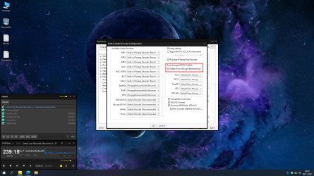

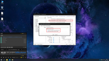

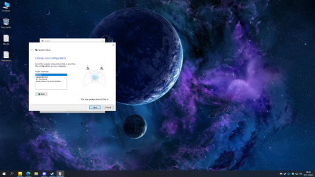

Dec 8, 2020
2,758 (2.25/day)
@Mussels, don't get me started on SPDIF and stereo, its more an OEM issue, it can do much more (interesting story). Indeed if you bitstream (aka passthrough), the device will enter exclusive mode.
He should be able to bitstream a supported format, and then set the receiver as needed, most I have seen you set the AVR to the format as a setting or mode.
If this fails at some point, you need to check two things, making sure the 6800XT is bitstreaming the data-audio, and the receiver directly.
DTS Trailers - The Digital Theater | Dolby Trailers - The Digital Theater (making sure Windows is set to stereo)
For PCM audio, you need to set the speaker settings in Windows to 5.1-7.1, then play a multichannel PCM file (examples here). Same checks as above.

Taken from here (click me)
And for Spdif:
S/PDIF is based on the AES3 interconnect standard.[3] S/PDIF can carry two channels of uncompressed PCM audio or compressed 5.1/7.1 surround sound (such as DTS audio codec); it cannot support lossless surround formats that require greater bandwidth.[4]
Taken from here
And this site here breaks it down even further, and what games that are out there that do true 5/7.s PC surround sound going from ur Spdif optical, or HDMI (click me) other then that, to get true PC GAMES to play in TRUE surround sound it must be either Analog or Game supports sending the codec UNCOMPRESSED through HDMI. For consoles this is no big deal at all, but a PC, its a PITA to get just "one cable to rule them all" for ALL have pros and cons, I am just trying to metion, if ur going to use even a cheap receiver, or a high dollar one, make sure it has ANALOG IN, not OUT in the back of it, and run a Optical, and the analog and then call that a day, if in the end run all you want it basic better then tv sound, for it can really take off down the rabbit hole very quickly when you find out what all this crap can really do if you take the time, and hook it all up right for YOUR situation(s)
Another Quality book written, and un edited by, funboy :D

A friend of mine has an AMD GPU which I cant remember the model, he had issues with the EDID and driver, in his case supported encoded formats where not showing even though present in the EDID.
He could not send the missing formats. I sent him an edited version of the current AMD HDMI driver (he previously had some other AMD driver), then all formats showed and worked.
My point being, its possible the driver might not be working properly, or perhaps you could try my edited one (I just made it install on all AMD audio devices).
If you would like to try the edited AMD HDMI driver, let me know, and I will build a basic installer for it, as it needs to be signed.
@funboy6942, now you have read my SPDIF post, you can try the technology for yourself, that is, if your receiver actually supports the format(s) on SPDIF directly (not HDMI).
