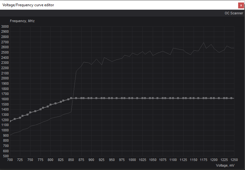

Not sure why it would be power throttling though, since the voltage is constant at 0.85 V. I've attached my custom Afterburner curve below.
Also, it seems that not having this GPU throttling should (?) be possible from this reddit post. However, this person's likely to be on a different BIOS version than me (hence why I asked them). EDIT: They've responded and we are on the same BIOS.
