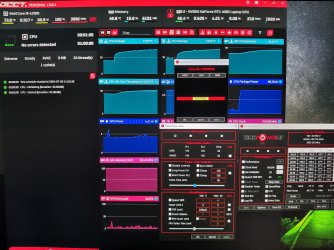

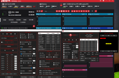

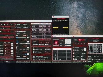

I have the same problem in laptop MechrevoKS16super, Win10. Laptop is plugged in, set in performance mode and temps are low. In TS benchmark TDP does not rise above 45W. Pl1 and pl2 100/120W. In Limits EDP other. In OSST test TDP maximum 80W. Can you help what the problem is?

Try updating to ThrottleStop 9.6
Delete the previous ThrottleStop.INI configuration file. Open the TPL window and check the MMIO Lock box.
TDP maximum 80W
If the manufacturer of your laptop decided to set a hard power limit of 80W, ThrottleStop might not be able to solve that problem.
I just noticed. You need to set IccMax for the core and the cache to the max, 511.75. It is impossible to do that with the old version of ThrottleStop you are using. That is why updating to TS 9.6 is important.
That helped, thank you very much. Now the processor is running into the temperature limit :)
And why should I set it to 511.75 and not less? Is it critical
Your CPU was previously EDP throttling because the IccMax current limits were set too low. You can set IccMax however you like. If you want EDP throttling instead of thermal throttling, lower IccMax. Maybe setting IccMax to 300 will be the compromise that you are looking for.
