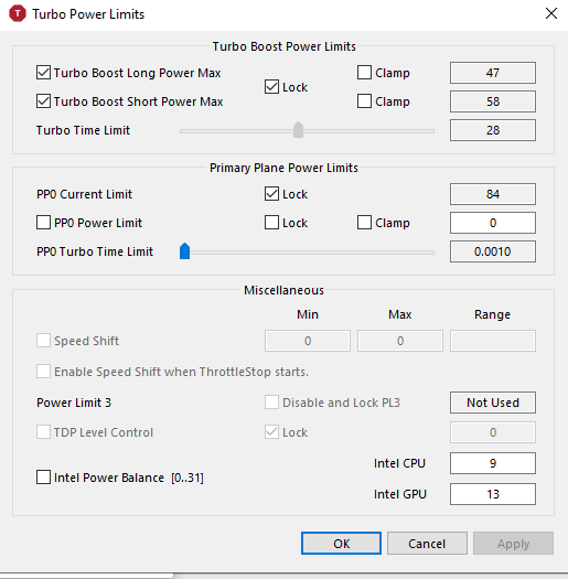

TPL window

If you want to try and make this throttling flag go away, enter this into the ThrottleStop.INI configuration file and restart ThrottleStop.
IGPU=32
That might allow the Intel GPU to use more power before throttling as long as this register is not locked.
EDP CURRENT across all 3 domains is usually caused by the PP0 Current Limit being set too low. On your computer, this value is locked so you cannot increase it or do anything about this type of throttling.
Your long and short turbo power limits are also locked. Use your laptop and stop worrying.

Core Power in Limit Reasons and PP0 showing up in your log file are because of this setting.
Dell must be using this setting to throttle your CPU. In ThrottleStop, check the PP0 Power Limit box and change this from 0 to 58. Also check the Lock option. This will help prevent Dell from changing this value.
I can make my laptop throttle like crazy too if I set the PP0 Power Limit really low. Dell have some really funny engineers working for them.
In your log file it looked like your CPU and GPU were not running too bad before this latest throttling started. Once this is set, time to play another game and run another log file. It is going to be very satisfying if we ever get all of these throttling problems completely fixed.

i did not see that , hmm i will change it .Tks bro
well i changed it to 58 and lock it but it still show GPU POWER and Core POwer though :( and my cpu kept in 2.7 ghz base
