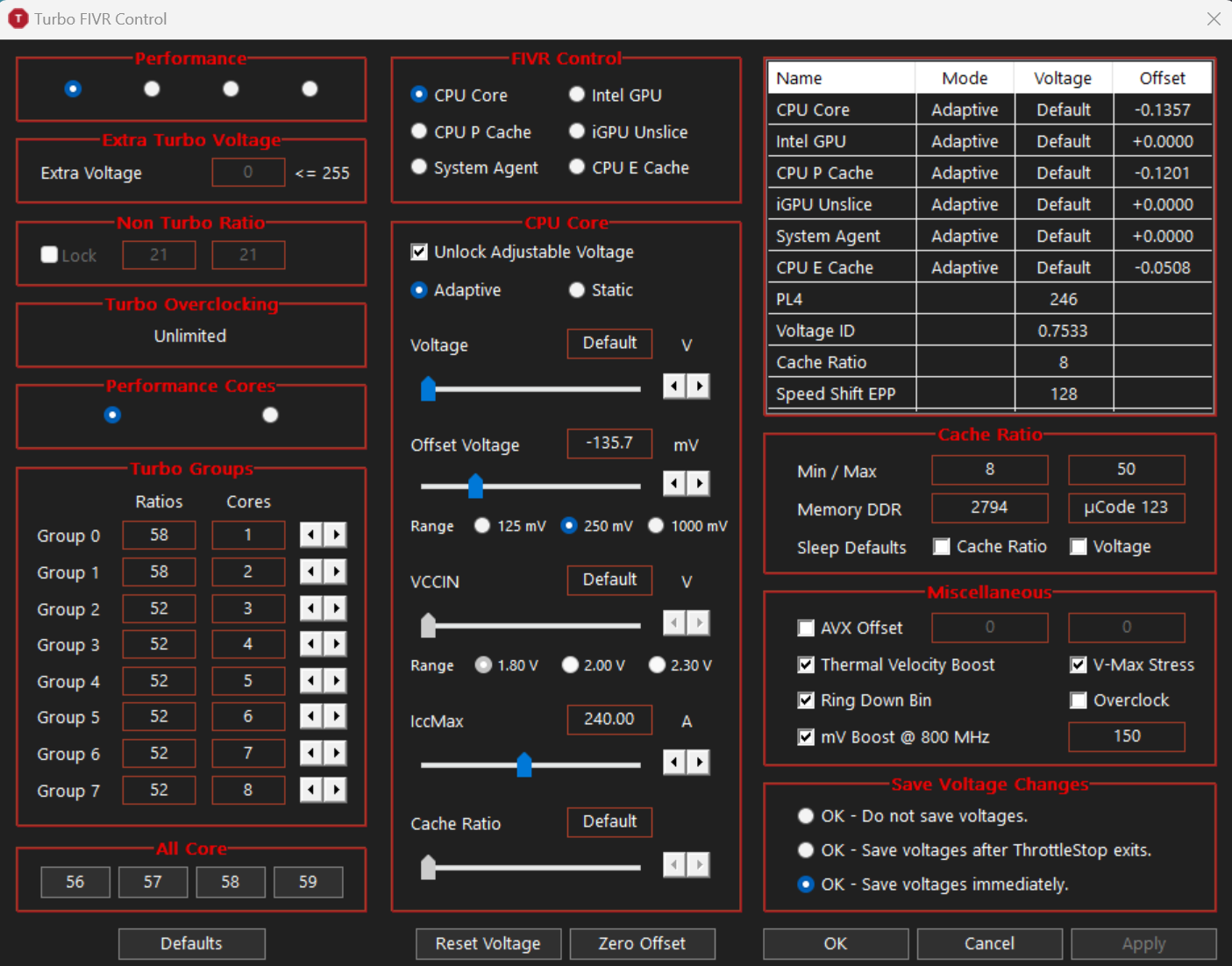

Hello! I bought a new laptop recently but it runs really hot even on idle, quiet mode and igpu only enabled. The only thing I've doing so far is coding and I have only played GOW 4 just to test out temps and FPS.
As you can see the offsets work for TS on the upper right corner. But in HWINFO it only shows 1 offset registering . The picture from HWINFO shows temps after running the Cinebench 23 on which I got 35k on.
35k was my initial score from a few days ago when tried running cinebench 23 on stock settings just to see what this laptop could do. I got 35k but really high temps. So I thought I should try UV with TS.
Since I have never done something like this before, I followed a YT video but nothing was working and temps were not going down. So I reset everyting to default and then after re-trying to run the benchmark on stock settings I was only getting 31k. I was afraid that I've just ruined a brand new laptop. For the past few days I have been reading this forum to learn a few things, to understand what does what and hence those are the settings I am using right now! I just got a cinebench score close to my old one so hope is restored. I am running the tests on a IETS GT600, Performance Mode from lenovo vantage. Why isn't HWINFO showing the minus offset values for all cores? I am getting 170w while running the benchmark and CPU throttles. My main goal is to find the sweet spot between temps and fps. I've tried playing GOW 4 on ULTRA, DLSS Balance I was getting 80 FPS give or take while playing and laptop was hot enough. I know I can do better! Any tips, help, suggestions appreciated!
When using the ThrottleStop mV Boost feature (which you definitely should be using), HWiNFO reports the mV Boost value instead of the undervolt values. ThrottleStop reports the mV Boost and undervolt values separately. I believe that ThrottleStop is reporting this correctly.
This has been reported on the HWiNFO forum so the programmer of HWiNFO is aware of this issue. If you set mV Boost back to 0, HWiNFO will report the offset undervolt values correctly. HWiNFO does not report any offset undervolt changes in real time. That means if you use ThrottleStop to make any changes to the CPU offset voltages, you will have to exit HWiNFO and restart HWiNFO so it can update the undervolt values that it reports. The ThrottleStop FIVR monitoring table reports the offset undervolt values correctly and it updates in real time automatically every second. You can rely on the info that ThrottleStop is reporting.

Setting PROCHOT Offset to 15 tells the CPU to start thermal throttling at only 85°C instead of 100°C that Intel recommends. That will reduce maximum performance and will also make your performance inconsistent from one day to the next.
Other than that, the rest of your settings look more or less OK. Your undervolt is definitely working.
Modern laptops with 14900HX processors can consume lots of power when running full load tests like Cinebench. They run hot, hot, hot. Undervolting will help a little bit but it is not going to fully solve this problem. A laptop with a CPU that can pull over 180W is next to impossible to keep cool and quiet. It is just the way it is.
