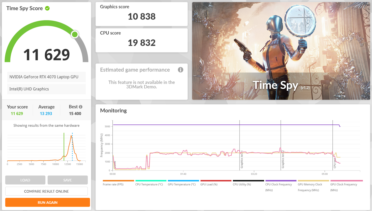

an all time high 3D Mark score for my laptop
Congrats. It always makes me feel good when I can get a score that is world class compared to other users with the same hardware.

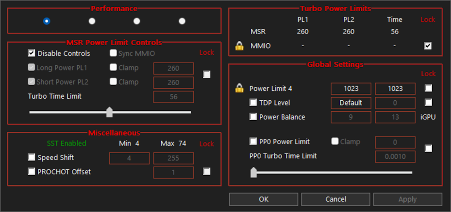

Would you please send screenshot of your TPL window? That would help me a lot
Both turbo power limits are set to 260W. This is good for running Cinebench outside during the winter. Most people with 14900HX powered laptops at normal room temperatures would need to significantly reduce those power limits to avoid thermal throttling. I use ThrottleStop to check the MMIO Lock box. Everything else in the TPL window is set in the BIOS.
Following the Valour549 guide, I set both power limits to 4095 and turbo time limit to the maximum possible (some thousands of seconds), since the OS will automatically manage the power anyway. Do you discourage this? What are your thoughts?
Also, what other power settings have you set in the BIOS?
The power limits I posted are enough for me to run Cinebench R23 at full speed for the entire run with both the P and the E cores overclocked +100 MHz. As long as a CPU is not PL1 or PL2 power limit throttling, there is no need to set the power limits any higher than that. It does not hurt anything if you set them both to 4095 but it also is not going to make your CPU run any faster. Power limits are like setting the height of a limbo bar. Whether the bar is set to 6 feet high, 10 feet high or 100 feet high, I will have no problem walking under it.
I like using the default 56 second turbo time limit value. Some people like setting this to the max, 3+ million seconds. Does it make any difference? Probably not. Most CPUs will ignore a sky high turbo time limit setting and internally will use a lower maximum value. I am not sure what that value is. It is not important as long as the CPU is not power limit throttling.
