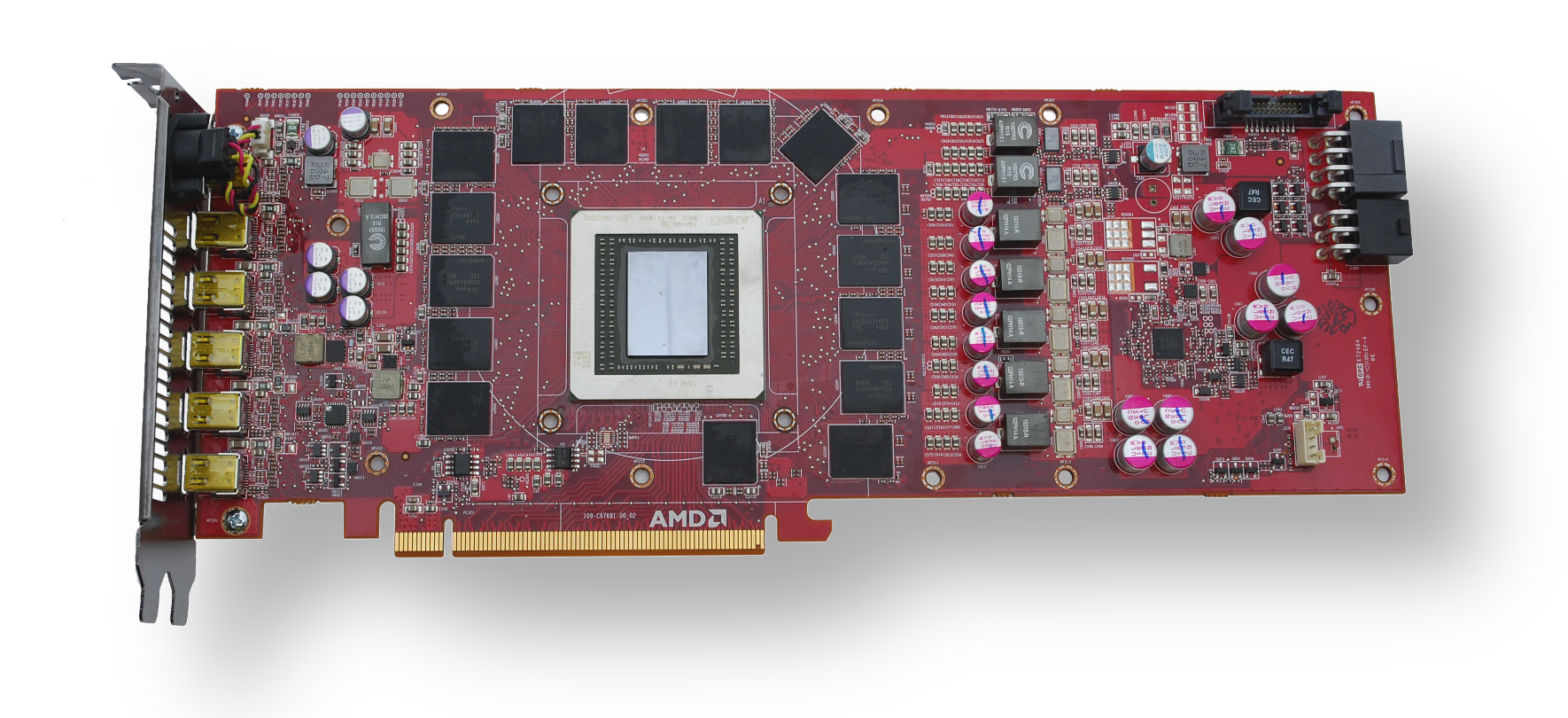

Maybe my understanding is wrong here then, so help me see where you're coming from.
In a traditional GPU the core is at the center, and the memory controller is functionally going to be the outside of the die. Thus, the limits of the silicon are further shrunk down by having the memory controller eat into them. With HBM the limit is moved from the die, to the interposer. Because the interposer is what is interfacing the GPU to its memory you run into the exact same spacing constraints, further complicated by having to connect the HBM modules to not only the interposer, but to one another in order to expand capacity (read: your earlier comments about the micro-bumps).
This effectively changes the limitations from one element to another, without ever removing the limitations. It also adds another complex manufacturing element to the mix, as the interposer was the reason Fury X was supposedly in small supply (with their small form factor offering basically being non-existent).
Tell me how this changes anything? I'm not aware of AMD suddenly having the ability to produce gigantic interposers (if you can prove me wrong that would be great, and I'd be happy to apologize for my ignorance). It could therefore safely be stated that the size restrictions are effectively unchanged. You have to contend with more heat, but again you can stretch chip placement out when they aren't forced to all fit onto an interposer. Put simply, Nvidia demonstrated the most elegant counter argument to Fury's performance by beating it roundly at the same or a cheaper price. While it makes me feel dirty to say it, Nvidiots have a point here. The Red team has yet to show us innovation, despite elegantly demonstrating that HBM isn't another Bulldozer.
I need a shower now. Saying Nvidia is reasonable and calling out Bulldozer just makes me feel unclean.
Correct. Memory I/O is obviously arrayed around the periphery of the GPU since memory chip -to- IMC need to be of equal distance (see the Tahiti die shot I posted in post #19)
Only partially correct. Fiji still retains (simpler) IMC's and PHY, as AMD's own block diagrams from the marketing slide deck show.
The interposer is not the GPU. The discussion centres around you contesting that Fiji would exist as it currently is (resource wise) even if saddled with the need for GDDR5 support.
The interposer is not the issue with Fury X's supply constraint - it is the micro-bumping assembly and verification (both of the HBM die stacks and HBM -> substrate). Tooling for the latter has only recently on line for packagers like Amkor (who assemble the Fury+HBM+ interposer package) for both 2.5D and the next gen of 3D stacked products.
Interposer size isn't the overriding constraint. The Fiji/HBM package is actually larger than the interposer is sits upon (and the metal layer that separates them). The interposer just needs to be large enough to have contact for the required micro-bumps on the underside of the HBM stacks. Making the GPU+HBM package larger (or the interposer smaller) just affects the density of the TSV's within the interposer substrate. Since Fiji combined a lot of relatively new ground for AMD (their largest GPU by a handsome margin and the first HBM implementation), they decided upon a mature/conservative (read old) 65µm process node, rather than add another layer of potential issue. Physical manufacturing size constraints determined Fiji. The interposer tech determines the chances of commercial success ( yield/delivery and manufacturing cost).
I just meant that all AMD needed was for Hawaii to hold its ground from it's rebrand start date of July 2015 to when 14nm comes along.
I wouldn't expect GDDR5X to arrive appreciably before the next generation of cards. I doubt any current cards would be retrofitted with GDDR5X. If 14nm (or more likely 16nm) is delayed and a refresh of lineup is "required", maybe you'll see implementation - but I doubt it. TSMC's 16nmFF+ seems to be on track at the moment and any potential refresh would have a very short linespan indeed. Also bear in mind that AMD no longer designs or lays out it own I/O (including memory) logic - that is now in the hands of Synopsys.
