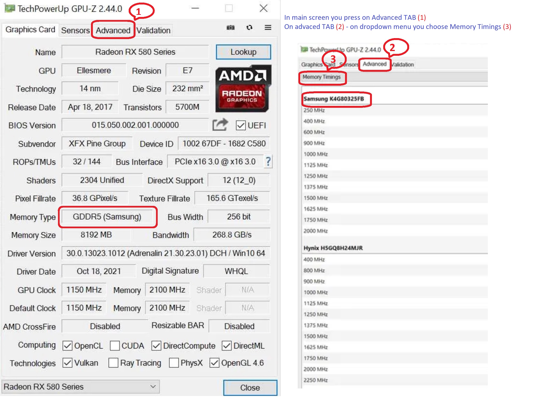

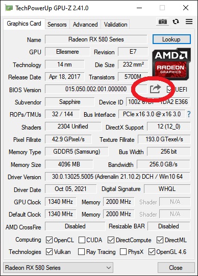

Using GPU-z to identify your card vendor and sub ID is great.
Put a picture from the main screen here.
Then in the main screen you will use the save BIOS button and you will store that file in a safe place for further use.
After that in the advanced tab you will press the drop down menu arrow and from the next menu that appear please choose the memory info tab.
Also make a picture and post it here.
