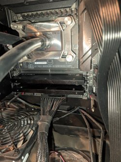

Yes i have Trident Z5 RGB ( 7800mhz /A-die 1sided) and i replaced the stock heatspreader with the Bykski one . Just heating up 3-4min with hair dryer and i could pull them off without too much effort.
I used the bykski 1mm pads for the back side and 1mm TR Odyssey pads for the front side ( RAM chips + PMIC)
Temps dropped by 3-5C

Did Byski provide enough pads for both sides?
Yes they provide 4 pad for the 2 heatsink (but i just wanted some higher quality for the front side ,so i ordered the Thermalright pad too.
Why does it need both sides? It's single rank memory right? Or is that needed to fill in space?
Yes , 1 sided .i added pads to back side just to fill up the space, so the hetsink is tight fit , it wont move .

Noctua 60mm fans are like 15cfm per fan. I don't think you are even close to an average 120mm fan, but you do you.
Some air better than none air.
Used to run them naked myself. Laziness and die shrink made it possible just to slap a fan on em.
Oct 27, 2020
12 (0.01/day)
True , but that 30CFM is focused directly over the RAM modules , a 120mm fan is overhanging the RAM slots by a lot .
