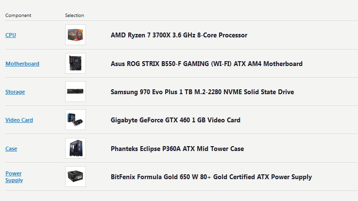

so i build my computer a few days ago and installed pop os on it but because of driver issues i decided to use windows 10 i created my media tool with the official microsoft thing on their website booted up my pc clicked install and got an error message saying "a media driver you computer needs is missing" i have already tried to flash the usb drive again but same thing again any help would be appreciated
Thanks in advance
edit: i am using a gtx 460 and am not sure but might have cms enabled sorry can't check right now

https://pcpartpicker.com/list/DjRjyK what bios settings would you recommend? don't know if its relevant but i have secure boot disabled
Hi,
Media the installer is missing is likely the m.2 driver.
I'd suggest having it on usb stick or use a sata 2.5" ssd instead.

Hi,
I've installed the m.2 driver in the os then system imaged after the sata install and restored it to the m.2
But you can install the m.2 driver during the install it's just a different process.
Try USB 2.0 for install. Error could mean windows installer don't have drivers for USB 3.

ok so exactly how would i install windows onto my nvme ssd i didn't understand what you meant

Hi,
On this screen you'd point it to the other usb stick with the m.2 driver on it.

But yes m.2 is most likely the missing driver.
Get it from samsung website
Put it on another usb stick and use Browse on the prior screen you showed.

I don't know
Some say the m.2 is defective is why the installer doesn't recognize the m.2
It's not the first time a samsung m.2 wasn't recognized but you'd have to attempt to install the m.2 driver.
If it doesn't help
Sata ssd and the install goes fine leave the m.2 installed and see what happens then.
